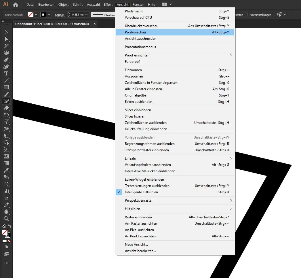

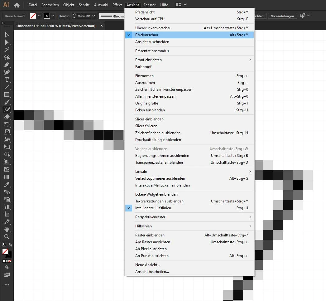

pixxxelschubser
December 11, 2019
Like Eric_Dumas mentioned
pixel preview on:
pixel preview off:
Can you confirm that?

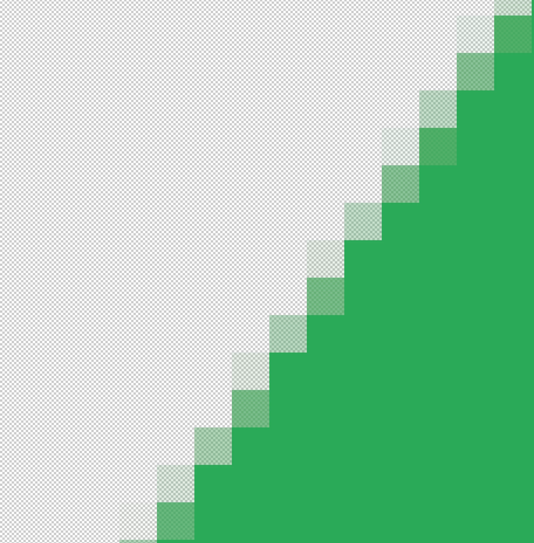

I don't see the problem when I look at the file, of at an exported PNG.
Now, if I zoom in to 2800%, then it shows in the PNG, but that is to be expected in a raster file, and it should no be being viewed at that size anyway.
