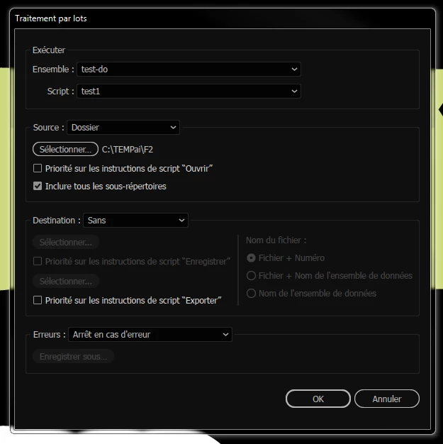

I'm leeching Adobe's and Stack Exchange's forums, but I can't find any recent post about this specific command:
           app.executeMenuCommand('ai_browse_for_script');
I want to run a action script on a batch of files without User Interaction, only jsx file - So this CMD needs more parameters like PATH and NODISPLAY. NB: this cmd showed up since CS6
It is not in guides CS6 nor CC2017 (we already knew that) So it's not present into Jongware's fantastic CHM reference guide; The best guide about menuExecCMD I've found so far is http://chuwa.iobb.net/tech/illustrator-cc2014-menu-comman.html
Maybe noone is using this which I highly doubt; the only documented workaround seems to doscript from VB which is something I could do, but I was focusing JSX for now.

I'm looking for the equivalent of this - NB: I don't car about errors as I debug them myself. I doing things 1 by 1, nowadays I [think to] know what I'm doing.
Thank you for your time, maybe my google-fu is stuck. Overall this is very important to have a complete control about what illustrator do, because I can manage keeping ram usage low with the For {} loop, indeed I can't save save my work until the otherwise I'll loose hours a day waiting Ai to save files
Possible workaround? Could I copy paste aia into jsx file? https://gist.github.com/moluapple/2568405
EDIT: app.executeMenuCommand('ai_browse_for_script';script1); is not syntax-correct
EDIT2 app.executeMenuCommand('ai_browse_for_script') is requesting vb or jsx file extension only
Image: This is the screen I want to get rid off keeping the same idea, instead there I will make the batch myself

I know you want to get rid of batch dialog, but...
You can put in a script into your File / Scripts menu and then have your action play that script. Adobe says they fixed the bug now which used to happen when Actions would 'forget' the script that was recorded into them.
So now you can just do batch actions and play your custom script on each file relatively easily. Since it's a custom script and it has to be installed in your Illustrator's application presets / scripts folder, wherever that's at, and it only shows up in the File > Scripts menu after Illustrator is restarted, having many different scripts in there could be cumbersome. However since it's a customs script, you can make it generic for your purposes and run off some arguments, such as a text file on your desktop, etc, in order to play various different functions by means of the one menu script.
