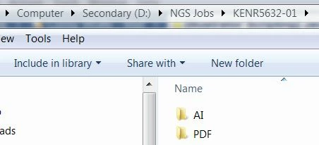

The folder location changes based on the job number. For instance:
Job KENR5632-01 is saved on my D drive in a folder NGS Jobs.
Inside that folder there are 2 folders AI and PDF
When I do the job for KENR5632-01 I save a file called Schematic.ai in the AI folder and Schematic.pdf in the PDF folder.
The format is always the same the only thing that changes is the job number (KENR5632-01)
