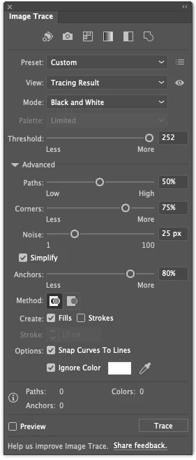

•  Javascripting parameters of the "𝐈𝐦𝐚𝐠𝐞 𝐓𝐫𝐚𝐜𝐞" palette, possible?
Hello -
I was wondering if it was possible to script the "𝐈𝐦𝐚𝐠𝐞 𝐓𝐫𝐚𝐜𝐞" palette
and in particular the parameters (eg. Threshold, Simplify, Ignore Color (White), …)
Thanks…

jduncan
May 27, 2025
Hey, you can edit most of the tracing properties like below (docs). I have found this can be a bit finicky so if you have issues as a work-a-round, you can first create a preset manually in the palette and then load the options from that preset using `TracingOptions.loadFromPreset()` method (docs).
Please note, `ignoreWhite` doesn't seem to work anymore (at least this way) and I assume it is because Adobe recently switched it the option to 'Ignore Color' with an accompanying color picker.

May 28, 2025
Hello  🙂
So many thanks it works.
One more question, I checked the documentation, and I don't see "options" for the "noise" and/or "simplify".
Does is mean that these options can't be scripted?
In the meanwhile and if it was not possible from the ".tracingOptions", I tried at the end of the script via the app.executeMenuCommand("simplify menu item");
The little problem here is that it opens the window of the "simplify" menu and ask for an user input.
Thx, enjoy your day.
- Dimitri
jduncan
May 28, 2025
Hey, so when you say "Simplify" are you referring to the a setting under the "Advanced" section of the Image Trace palette? If so, the options for the first three settings in that section are:
Paths: `pathFidelity`
Corners: `cornerFidelity`
Noise: `noiseFidelity`
They don't seem to be documented as you noticed but I have successfully set them using the same script from above but adding the line below for the expand operation.
tracing.tracingOptions.pathFidelity = 30;
tracing.tracingOptions.cornerFidelity = 20;
tracing.tracingOptions.noiseFidelity = 10;
