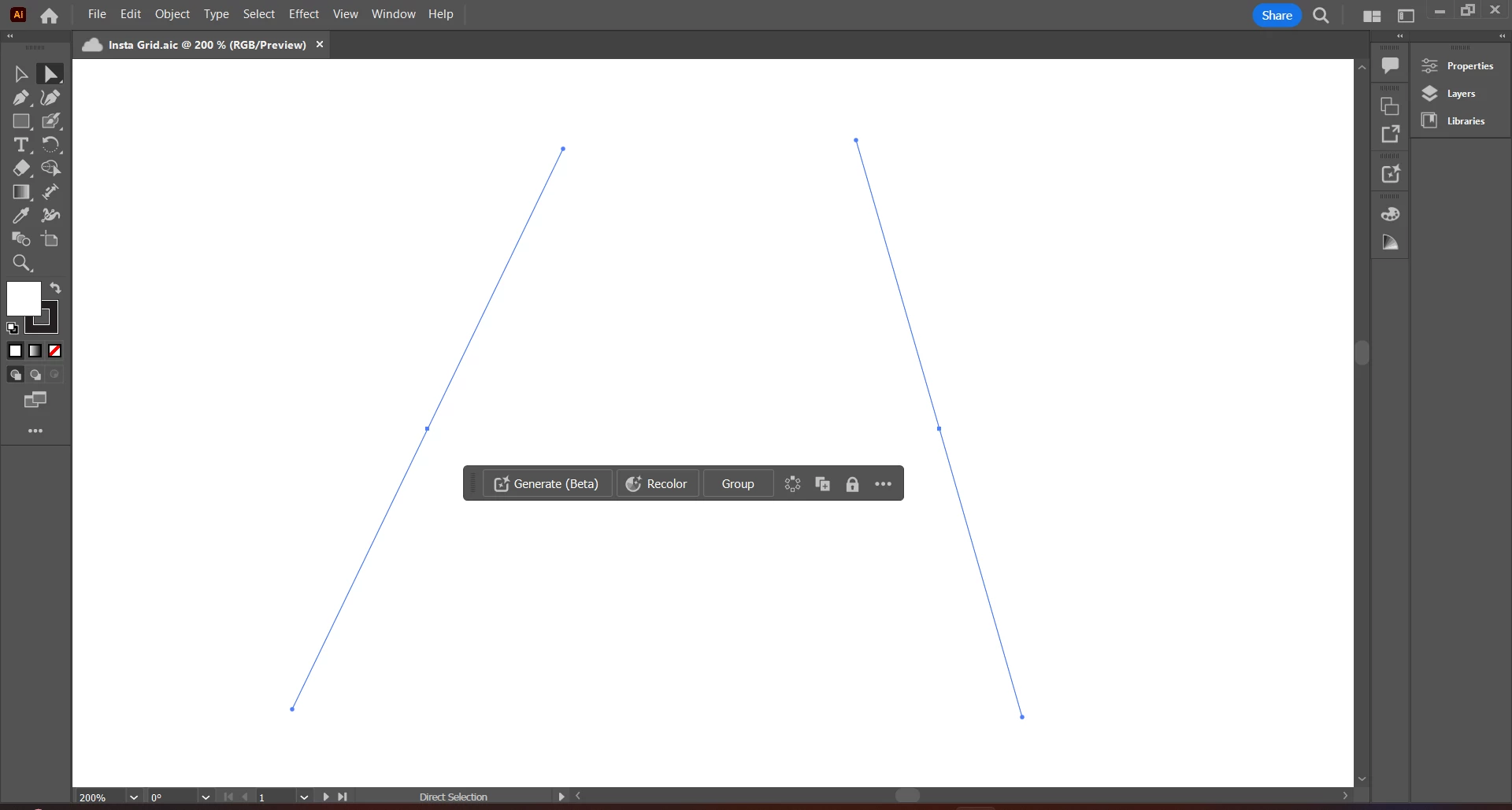

I have two stay anchor points with handles like this:
I just want to join both of them by preserving their handles, so that the result would look like this:
Is there any way to achieve this?

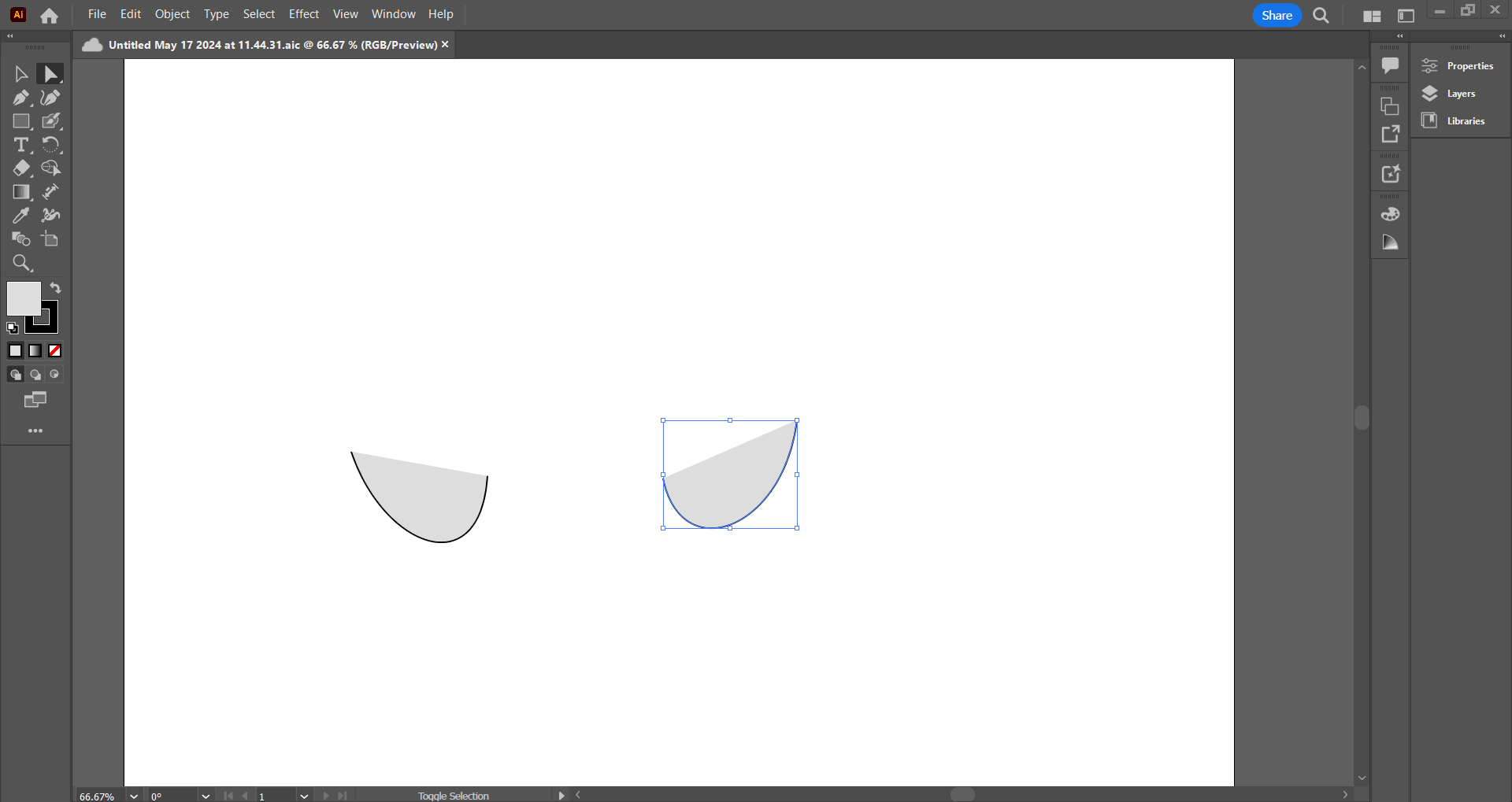

This works for joining 2 anchor points (Sometimes also for more anchor points, as I'm unable to cover all the cases). This creates a new line segment of 2 endpoints that are placed in the positions of the original anchor points and adjusts the handles of the endpoints to match the handles of the original anchor points.
For joining 2 endpoints of 2 different paths: 
While this doesn't join the 2 points, it only places the curved segment over the selected two points and doesn't remove them. This requires each of the points to be joined (Ctrl + J) manually to obtain a continuos path.
However, this sort of solves the original issue. Wish adobe implements such features, that reduces manual work upto some extent.

Raj,
I am afraid that "so that the curve forms automatically based on the pre existing handle points" is out of the question, owing to the inevitable disappearance.
I believe the (only) way is (still) to use the Line Segment Tool as follows, Smart Guides being your friends, see images below:
1) Select the first (left) stray point with the Direct Selection Tool, then with the Line Segment Tool ClickDrag from the Handle extended towards the other stray point (outgoing) into the Anchor Point (Smart Guides say handle, then anchor when you are within snapping distance);
2) Repeat for the other one, only from the opposite Handle (ingoing);
These are your guiding paths, shown in red;
3) Lock everything, then with the Pen Tool ClickDrag along the guiding line from the first Anchor Point to the first Handle to also recreate the Handle accurately, then ClickDrag along the oother guiding line to complete the path also with the other Handle recreated accurately;
4) Delete/hide the original stray points and guiding lines.
Click to get closer
