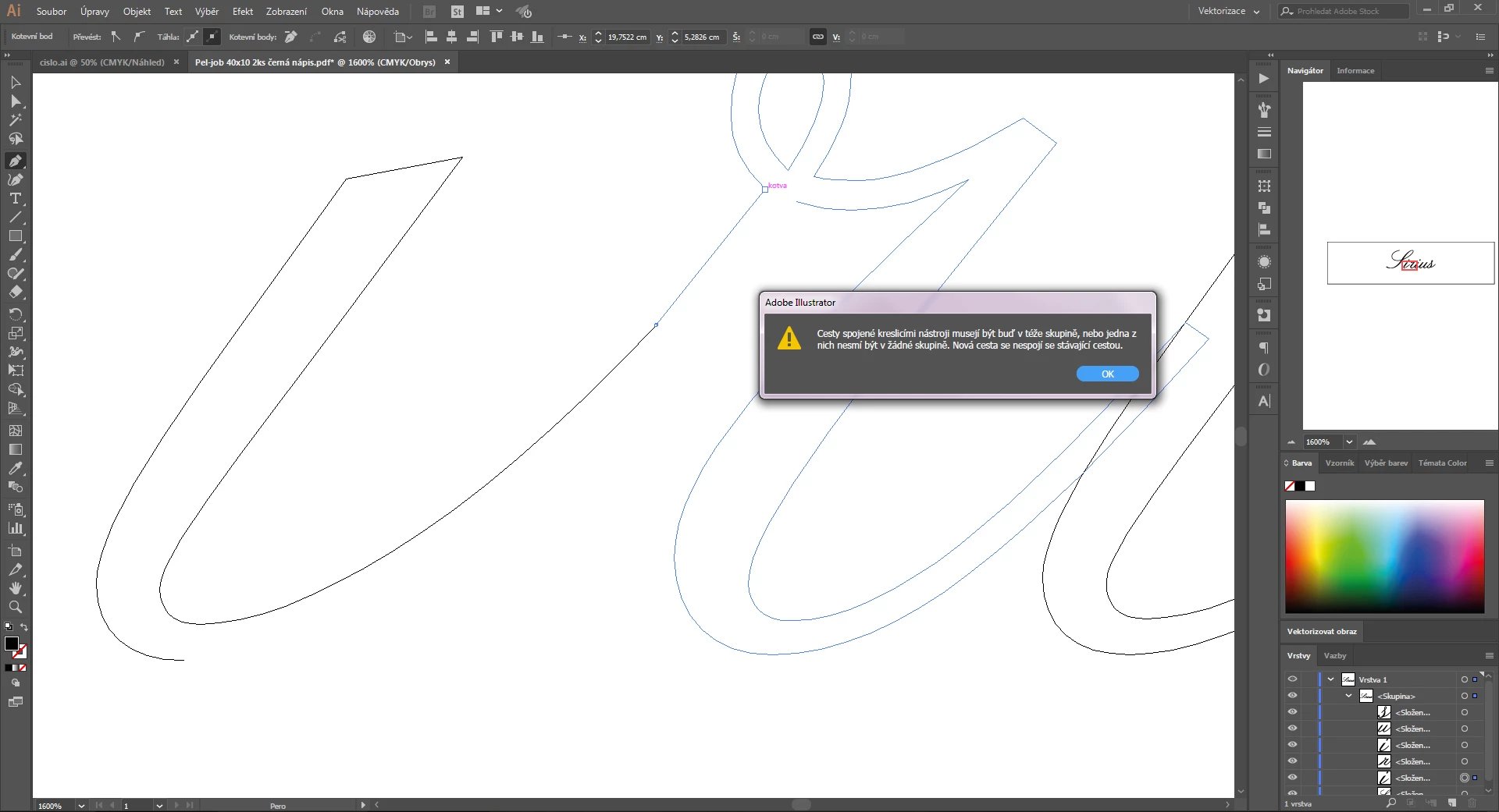

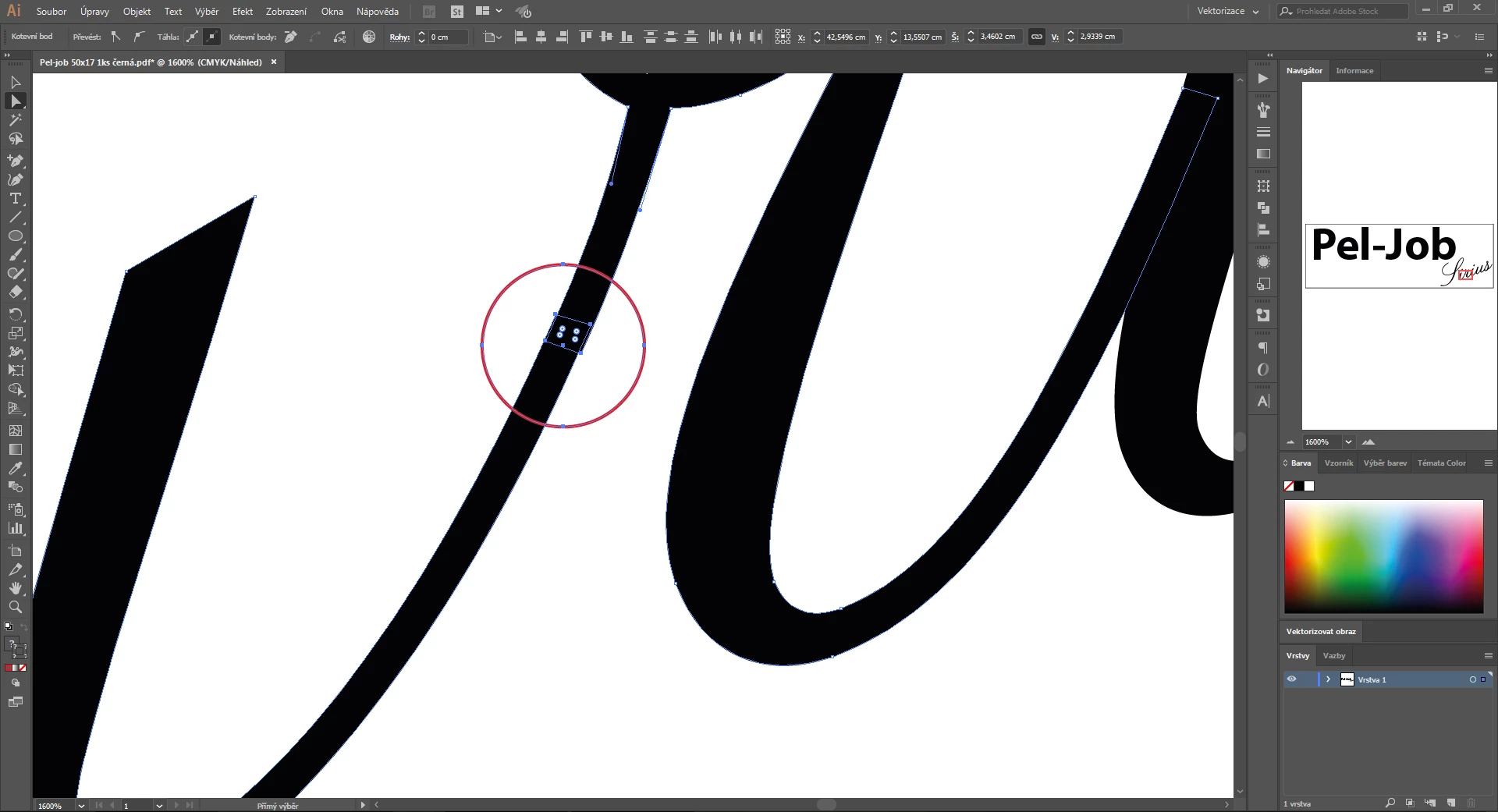

Hi, I need to join 2 anchor points on the top of the path and 2 anchor point bellow together to make the line smooth. Originally it is the text but if I choose 2 anchor points together, there is no option to group them. Even if I put one on the other one, there is still path crossing the line and can not make it as a one. Thanks for the help, I hope it is very simple.

    If I could see your illustration, it would be easier to troubleshoot the issue.
    Illustrator can join 2 anchor points at a time. Is it possible that there are more than 2 anchor points at the same location? You could try temporarily moving the anchor points to see if there are more than 2. Choosing View > Outline might help to see more clearly.
    It is possible that there is a stray anchor point at that location, and that would be hard to see. If that is the case, deselect everything and choose Select > Object > Stray Points.
    It's difficult to see what's going on in the screen capture, but it looks like there is a rectangular shape on top of the main shape. If that is the case, you could select the shapes and in the Pathfinder panel click the Unite icon.

    VitAuthor
    March 13, 2020
    Hello Jacob, thanks for the help. Unfortunately i have to create the smooth black filled shape, because of the following cutting in our machine. The problem is, if I remove and replace the new line with the pen tool - it is not possible to connect them. The Illustrator says "The paths must be in the same group. The new path will not connect with the existing path.". But at the same time I can not group them. I can just change the text font or whatever, but I would like to solve this problem to the future 🙂 Thanks again for Your time.
