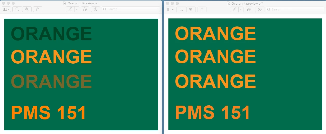

    There may be overprinting elements, and overprint preview is turned off in Illustrator (View> Overprint preview).
    The left screen shot shows type with overprint fill on, off, and on, (with 50% opacity type under it), respectively.
    The right screen shot shows the same file with overprint preview turned off.
    To change the overprint setting, go to Window> Attributes.
    If this doesn't fix your issue, try saving your Illustrator file as a PDF (using Illustrator defaults), then export to an image from Acrobat (File> Export to> Image.
