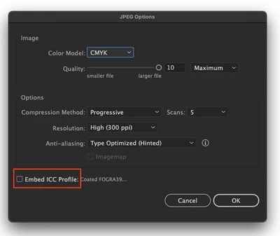

Anshul_Saini
July 15, 2022
Hi @defaultwo0pjd4fvyt4,
Sorry to hear about the trouble you are facing. I agree with @Ton Frederiks. Many users have reported this issue in the past. Are you using the Photos app to view the CMYK jpegs? For some time, there has been a bug in the Windows Photos app while seeing the CMYK images, or it's possible that Microsoft dropped the support for CMYK images.
If you are facing a similar issue, please try one of these workarounds
until it gets fixed by the Microsoft Windows Product team:
  • Export images in RGB.
  • While exporting the images, uncheck the Embed ICC Profile option.
  • Open the images by default in the Windows Photo viewer app.
I hope this helps!
Thanks & Regards,
Anshul Saini
