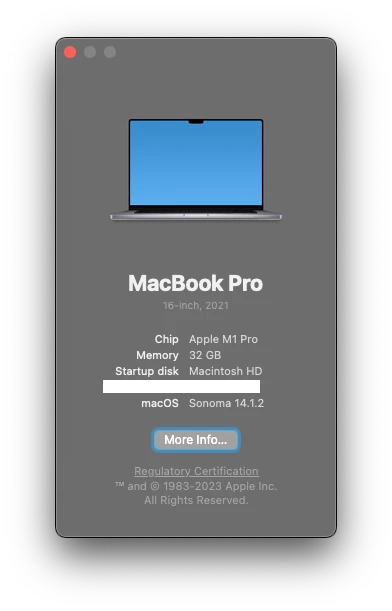

Having the same issue recently, which is really weird. This wasn't happening last week, which made me think it's software related or OS related, but it was happening on both 14.1 and now 14.1.2. Could be something our IT department installed in the background(?) too but didn't see anything in the system report that stood out.
Random lagging when selecting and moving objects. Usually results in moving said object by a couple pixels, which is extremely annoying. Simply moving the mouse around the file within INDD rockets the CPU usage to around 65%, and when the lag/hitch occurs, it goes up to 75%. Not sure if the two things are related but thought it worth mentioning.
Did all of OP's troubleshooting methods to no avail either.
