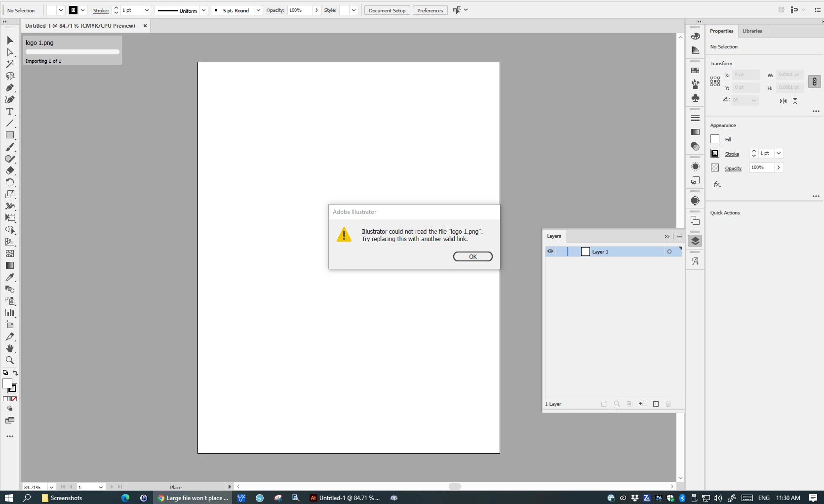

Large file won't place as link in Illustrator – "Try Replacing this with another valid link"
  • April 20, 2020
  • 14 replies
  • 18850 views
I am trying to place a linked file onto my Illustrator artboard and everytime that I try to place it I get the following pop up after it tries to place. I've dragged the file from my desktop onto the page and it allows me to embed the file, but when I try to "unembed" and link the file, I get the same message that "illustrator cannot read the file. Try to replacing this with another valid link"
I have resaved the file as a different color format in PSD to see if that would help, it didn't. I also tried restarting. Uninstalling illustrator and reinstalling it.
Please let me know if you have any suggestions!

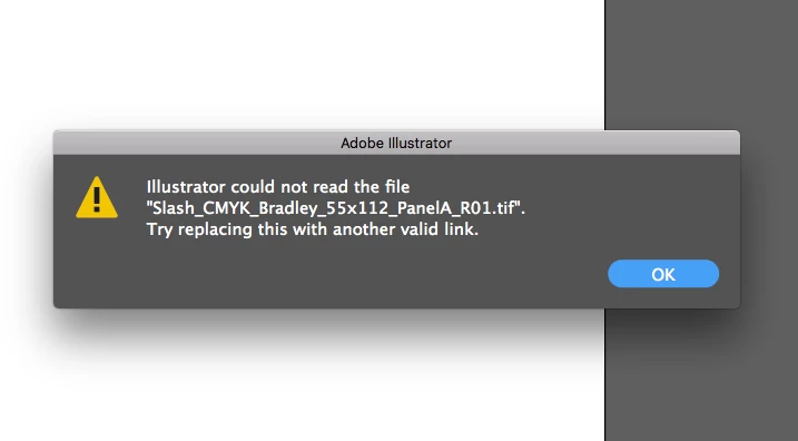

I make a LOT of murals that I lay out in Illustrator.  This has got to be a bug because, you can't "place" a very large .tiff file, but you can "open" it into Illustrator.  Then you can copy it into whatever you want to use it for.
Thats how I get around this weird bug.  Open, then copy and paste(embedded) into your document.

I've been getting this with converted PSB (Photoshop Big) files.
Whether I save out of PS as jpg or tif, Illy will not import, says invalid file format.
Solution has been to open converted file in Preview and do a new SaveAs. (I'm redrawing everything so the quality is not an issue. It's a pain though!)
