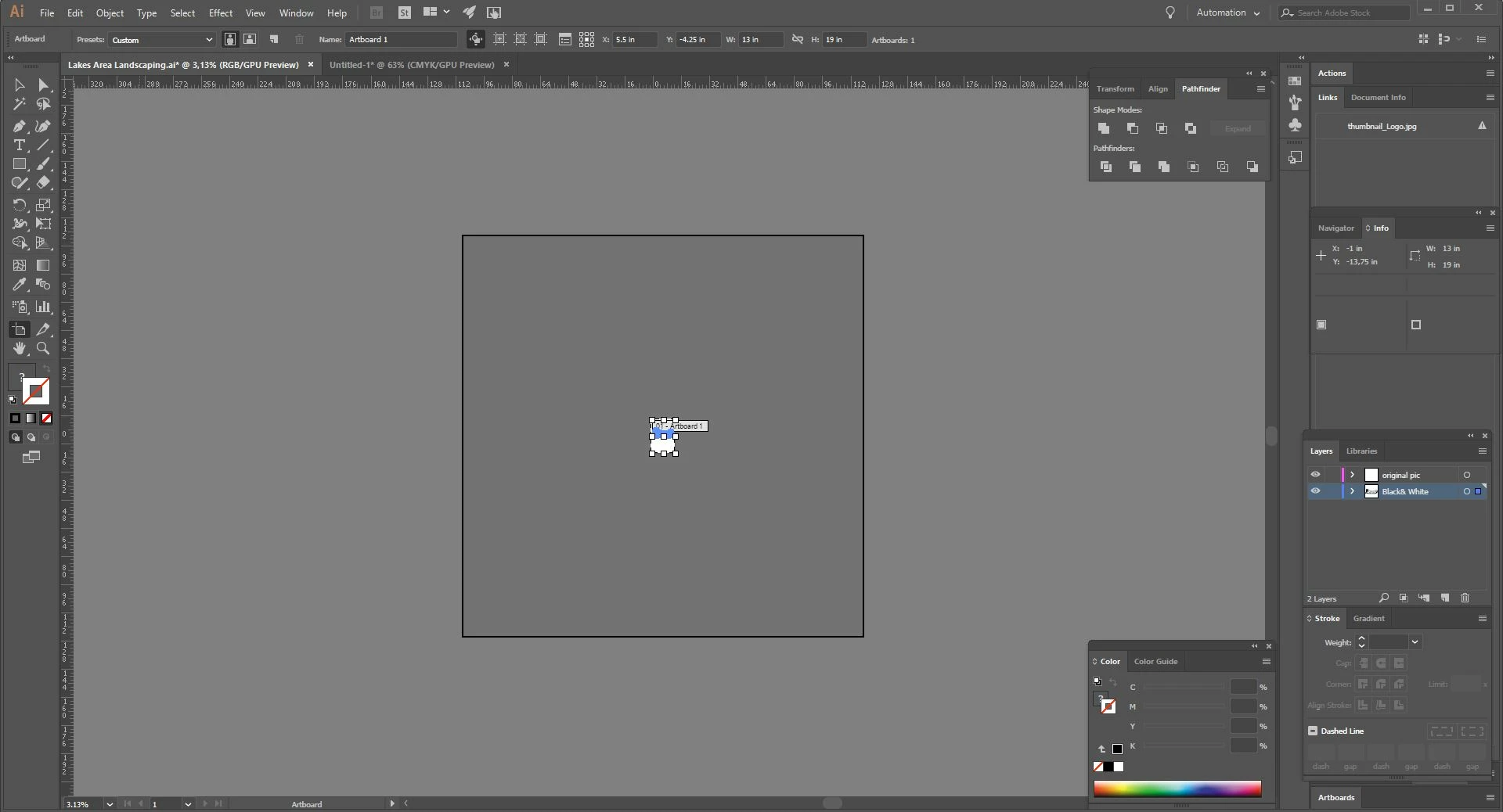

large white space outside the artboard??
Hello, I am still new to illustrator and am having an issue, my artboard is small but when I exit out of changing the artboard size I get a huge white space attached are
some screen shots. can anyone explain?? Thanks

    Just happened to me too, I accidentally activated it while trying to use a keyboard shortcut to save my project file.
    Instead of pressing CTRL+SHIFT+S, I instead pressed CTR+SHIFT+D.
    And I just needed to press it again and the issue is gone.
    Alternatively, you can navigate to View>Show Transparency Grid.
    That's all guys,
    Good day 😉

    Go to View > Show Artboards or press Shift+Cmd+H

    Pressing Cmd + 0 should fix it.

    You're talking about the WHITE area, correct? And it's bigger than you hoped? Did you want it to crop much closer to your calligraphy artwork that's seen at center? Is it possible that there was a different unit of measure being applied than what you thought you were using? Recheck your numbers a nd  be sure to note whether it is inches, mm, cm, etc.

    You are zoomed waaaayyy out. This is the canvas. You cannot change its size.

    I am zoomed out o show whats going on, if its the canvas how come other files I work on don't have it??

    They all have it.
    Your other apps might show differently, but they all have it.
