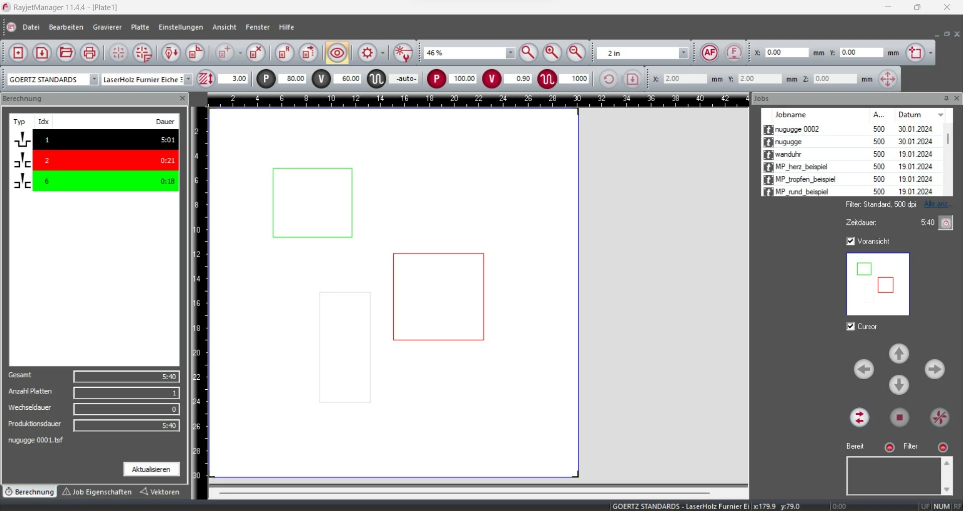

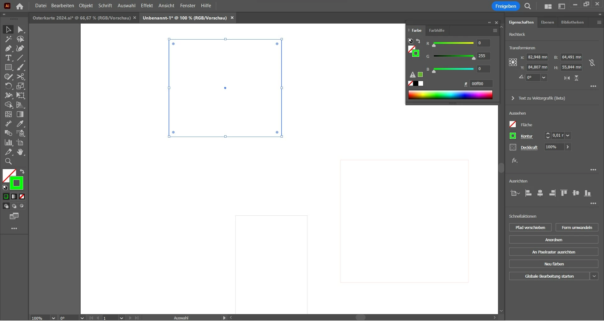

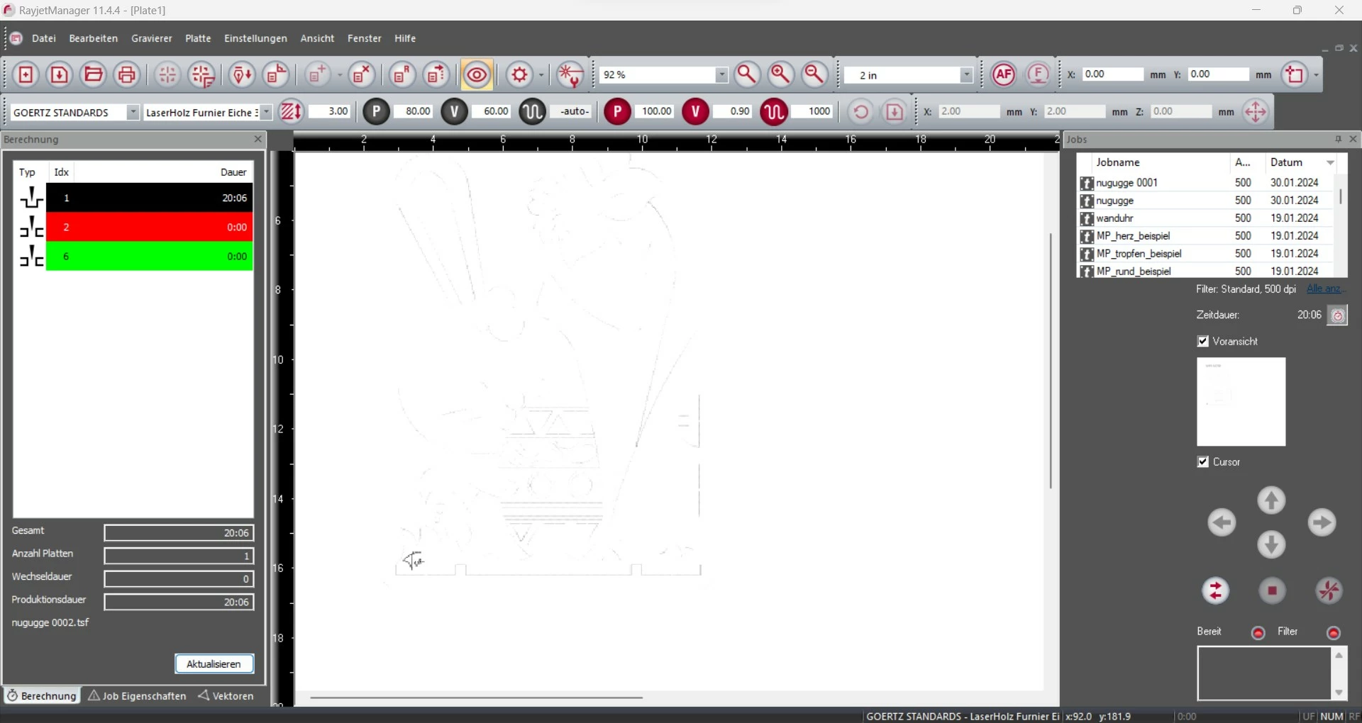

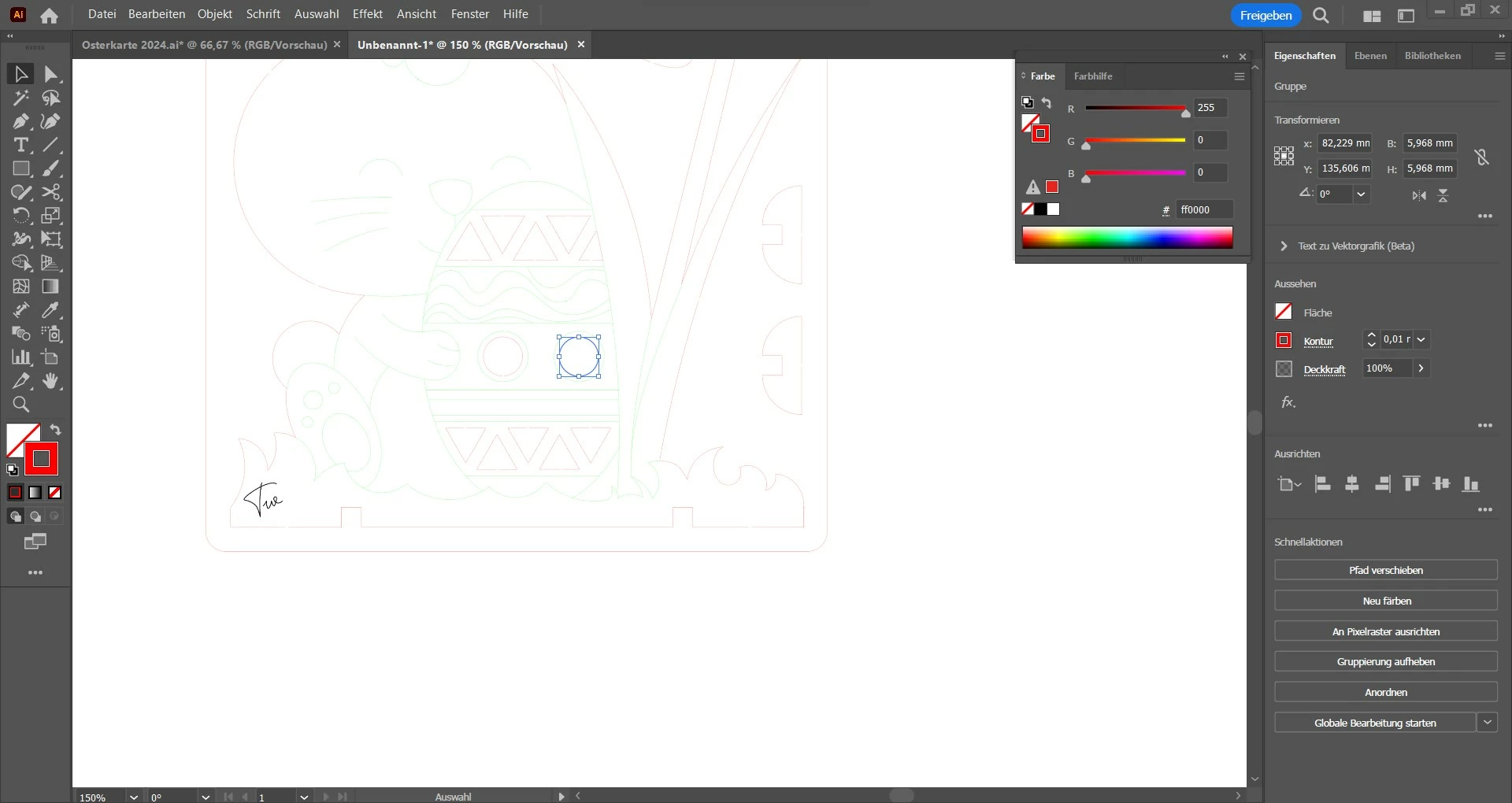

A colleague of mine drew a design in ArchiCAD and sent it to me as a DXF file, which I opened in Illustrator and edited there. As I'm used to Illustrator, the settings like RGB colours, line thickness of 0.01mm & co are familiar to me and all set correctly. But nevertheless, when I 'print' the file to Rayjet Manager, there the red/black/green lines suddenly will appear in grey. I attached some partly screenshots to make clear what is my problem.
I already called Trotec/Rayjet Manager Support and they are sure, the problem is not there and I can also say that, because when I open a whole new document and quickly draw three circles - one in red, one in green, one in black - and then export that to Rayjet Manager, it is displayed correctly. When i copy part of the problematic design to that new document with the circles and export that again, it will appear in all grey again. So I'm pretty sure, the problem is with the imported data from my colleague. All lines are paths and after editing the design, I saved it as an .ai file.

In Illustrator I click 'Print' and then as the printer I select the 'Rayjet Manager Engraver'. But the problem isn't in the printer, because I already  installed it new yesterday and other designs are working well with that printer now - and the same printing settings. So I came to the conclusion that there has to be a bug/mistake in the design document itself but I have no more ideas where to search or what to try.
I SOLVED IT
If anyone is facing the same struggle, I quickly want to let you know what was the reason in my case:
I added our logo as a png to the design and after I removed that, it worked. So the png-file with transparent background was the problem. Now I included it as jpg with white background and everything is fine.
