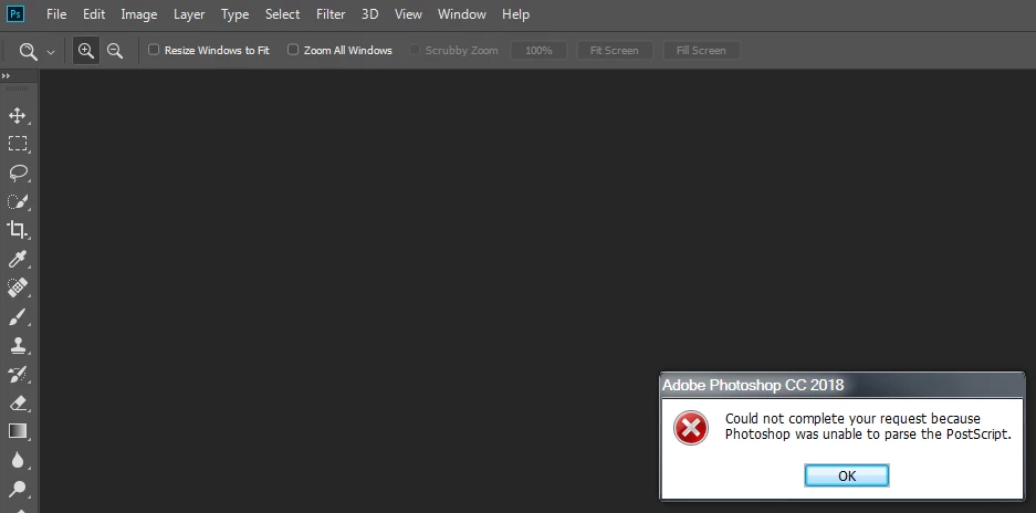

Sorry to interrupt your discussion here, but it seems here i found people that have knowledge about the problem I have, posted as new topic:
Photoshop CC 2018, Windows
File I try to open is https://wetransfer.com/downloads/64170fb79201c8ec7c0812fa366eadb920180919122613/b75b07
This is the error message shown; when I open same file in Illustrator, it opens without a problem. So what in this EPS file prevents opening in Photoshop? Could it be something with legacy text?

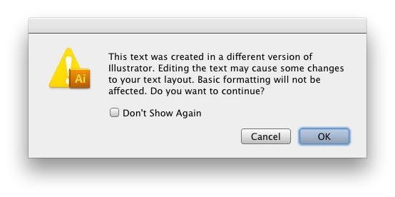

I've been using a similar method to detect legacy text, I even used your exact code which returned no results. I'm absolutely sure that the message I'm receiving is not the usual "Do you want to update the legacy text [Update] - [Leave for Later]" message.
Here's the message we're getting:
It seems that the text frames in question aren't actually legacy text. However as the message suggests, they do contain text that was created in an earlier version of Illustrator. Perhaps it's been copied from artwork to artwork through various Illustrator versions. After closer inspection, the text exhibits some unusual behaviour.

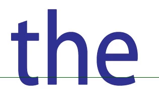

Here's an example showing the text sitting just below the baseline when its frame is selected and viewed in preview, however when viewing it in outline mode, the text appears to be sitting on the baseline.  Any attempt to either edit the text or move the text frame results in the text 'jumping' and sitting on the baseline correctly. The warning message only appears when I click inside it with the type tool, doing anything else results in what I can only assume is a reflow without any kind of warning.
Not all text that shows the warning when edited exhibits these properties though, sometimes the warning appears but there's no visible reflow and everything's seems fine. However, even the smallest change in text position or layout could have a big impact on our business if it goes un-noticed.
The only theory I have now is that it was caused by maybe a character or paragraph style that was applied in an older version of Illustrator, perhaps CS or CS2 and has been 'carried over'.  I've been fiddling with the SDK for most of the day in an attempt to detect this text without causing a reflow but with no success so far.
