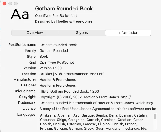

Jul 8, 2024 11:24 AM UTC
Hello Brecht,
we are having the same issue. (See screenshot).
The font is GothamRounded Book. We where using Fonts Connect, but the same problem exists when using RightFont (and probably others).
We use the Dutch (Nederlands) hyphenation library.
Closing the file and re-opening also solves the problem because the font already is active when opening for the second time.
This is a font related problem, because this never happens with other fonts. I will also add the font info.
Did you receive any news from Adobe yet?
Kind regards
Peter Hebbinckuys
Belgium
Anubhav M
Jul 8, 2024 4:37 PM UTC
Hello @peterhebbinckuys,
I'm sorry to hear about your experience. I tried replicating this on my end but was unable to. Would you mind manually turning off the Font Management program and installing the font to check if it helps?
Looking forward to hearing from you.
Anubhav
Jul 9, 2024 6:53 AM UTC
Hello Anubhav,
Thanks for your reaction.
In deed uninstalling the Font managment, of turning off auto-activation helps for sure.
If you in any way activate the font manually in advance (with or without font managment program), the problem does not manifest itself.
It's always in combination with autoactivation from a font manager.
This also means that if you open the file and the font gets auto activated, and you close and re-open the document a second time, the problem dissapears because the font was activated on the moment that you open the document the first time.
If you want, I can send you the files over a private link for testing.
Kind regards
Peter

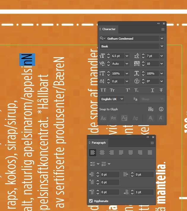

Apr 17, 2024 5:40 PM UTC
You might be better off activating the font in your font management program > restart > then open Illustrator first ( this should load the font in start-up ) > then open the file.
Apr 18, 2024 6:28 AM UTC
Yes, indeed, this would work. But auto activation is one of the reasons why we use a specific font management tool.
Mike_Gondek10189183
Apr 17, 2024 5:15 PM UTC
What font is this, and what language install are you running eg: English USA.  Can we see a screenshot with the "n" selected and character & paragraph palettes expanded?
Apr 18, 2024 6:47 AM UTC
Hi, the font is Gotham Condensed. We're using International English as install language.
