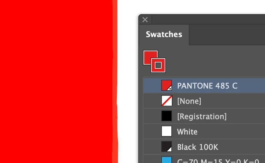

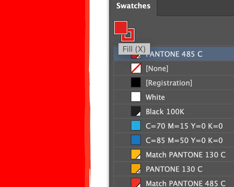

Why does the line and fill look different here? Both the line and the fill are the same color. The line is one of the standards in the Artistic Chalk & Charcoal palette. (see screenshots attached)
AI 28.4.1, Mac OS 14.4.1.

Check the brush.
Drag it out of the brushes panel. and then check the black color. Most probably it's not really black. If it's an RGB file, the black must be RGB 000
Then correct that and drag it back into the panel again.

There are brushes like the Artistic_ChalkCharcoalPencil set that have their color as 100% K (CMYK Black) defined.
They expand to the RGB version of a CMYK Black (29/29/29 or 88,3% K).
If these brushes were made with 100% Grayscale instead of RGB or CMYK values they woud work in both RGB and CMYK documents.

April 25, 2024
Good suggestion, thanks. It wasn't pure black. I noodled around and changed the coloring with the colorizations options, now I just have to figure out what I did! I changed the options, and then un-did everything, and the color changed to what it should be. Magic, I guess.
