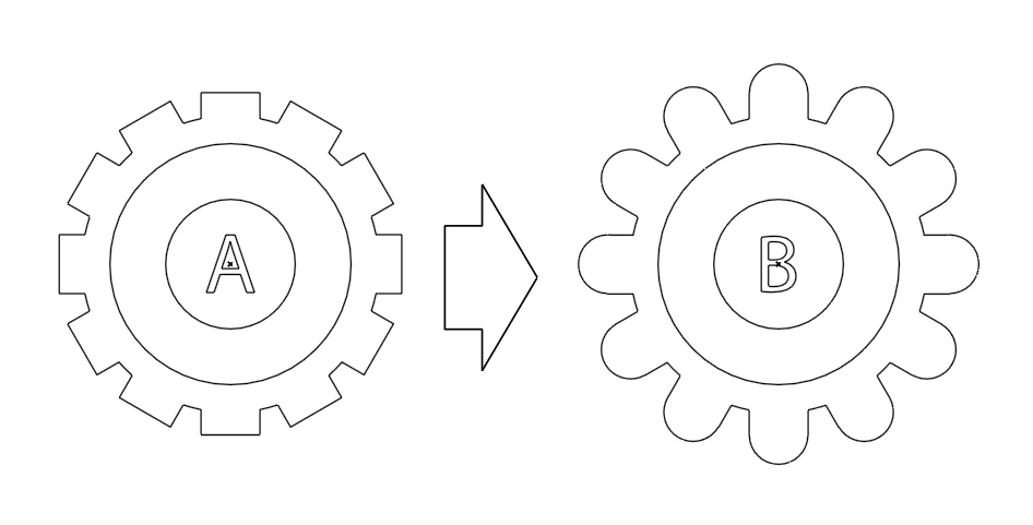

Is there an easy way to convert a line segment to a curve that imitates what I did in this example? I'd like to select the line segment at the end of the spoke, then convert it to a semi-circle. If I drag the corner widgets in, I can imitate the round ends, but there are always to point stacked on top of each other as seen in the second screen grab. Some of the CNC software choke when two points are directly on top of each other.

Mike,
Some of the complications presented are that in some cases you start out with rectangular ends (constant width spokes) simply requiring half a circle, in other cases the angles are sharp (widening spokes), in still other cases the ends are skewed (as in your attached link here https://community.adobe.com/t5/illustrator-discussions/line-to-curve/m-p/12881267?attachment-id=105756 ).
While we wait for a serious solution or for the end of time, whichever occurs first:
How about this cheat for the rectangular end case presuming at least one of the spoke sets is horizontal or vertical (as in all yous samples shown)?
1) Select your (rectangular end) spokes, then Object>Path>Offset path inwards (negative offset) by half the spoke width less a (moderately) wee bit and with Miter Joins, see below for elaboration on the meaning of wee;
2) In the Transform panel add the spoke width to the W value (for a horizontal spoke set) or to the H value (for a vertical spoke set) and hold Ctrl/Cmd and press Enter;
3) Object>Path>Offset path outwards (positive offset) by the same number as in 1) but with Round Joins.
Elaboration on the meaning of wee:
Wee could be moderately wee (such as 0.5pt), which leads to dual Anchor Points at the tips, close but not coincident with a distance of about two wees as a straight segment, which again leads to narrowing of each rounding by about a wee.
Or wee could be seriously wee leading to very close to coincident points, or even to some single Anchor Points, and to possible real weirdnesses (or would that be weeirdnesses?).

Rather than try to convert the end to a rounded shape now, it's better to start that way from the ground up.
The easiest way is to simply create your shape with 3 strokes, give the strokes a rounded cap and a width of "whatever" to get the shape you want, then convert that to outlines (and then Unite in Pathfinder).

Hopefully, the file will open. In the other software, I simply selected any or all of the line segments at the end of the spokes, and with one "make curve" command, created the perfectly rouned ends. I don't know if Illustrator will do this?
If I were to do the Widget thing, the results give me stacked points at the high point of the curve, and it shortens the strokes of the spokes.

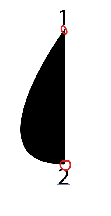

You are creating a tear drop shape the long way and getting extra points where tangents are. Instead try:
  1. click and let go to draw point 1
  2. move mouse down, hold down shift to constrain, click and drag to get curvature you desire
  3. click back on point 1 to complete shape
Illustrator does not have a command to remove the duplicate points exactly;y as you ask. Closest is
Object >>Path >> Cleanup >> Stray Point - sounds good, but wont do it is for single unconnected points
Object >> Path >> Simplify - might do it sometimes if you go towards maximum points in this situation and worth a try, but not reliable and can make worse especially if you want a perfect symmetrical curve.
I finally figured out how to add the image to the message! Anyway, I was looking for a fast way in Illustrator to select the top edge of the gear sprockets and turn it into a half circle--on an image what was alreayd built. In Illustrator, it would mean converting the line to a curve, then pulling out the curve handles to imitate a semi-circle top. In my Omega (sign design software) I can select all of the flat tops, then hit one command: Make Curves and it does the rest in a split second.
