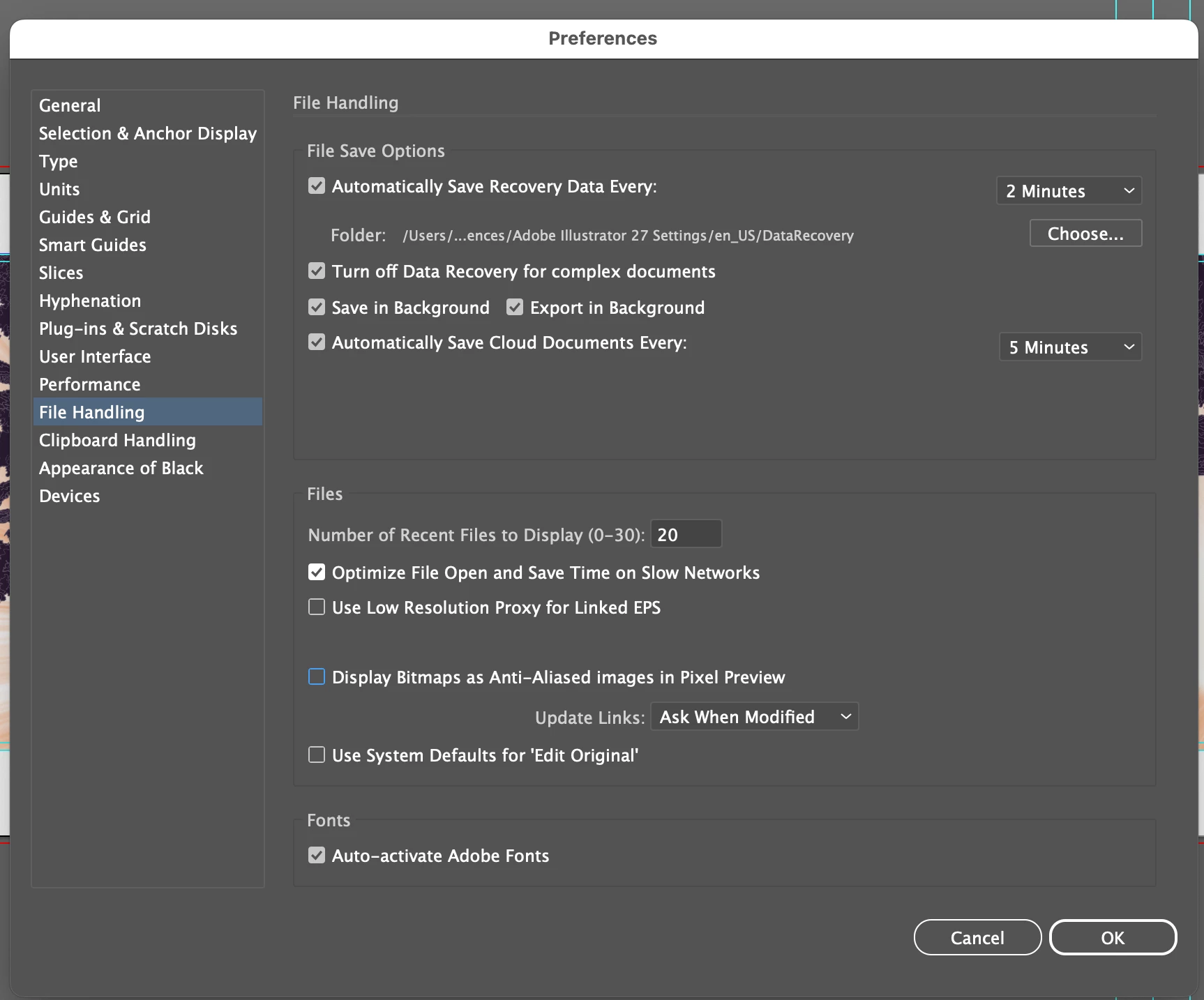

Using a macbookair OS14.7 AI28.1
In the past, when I made a change to some artwork that was linked to an AI project, when I returned to AI, I would be prompted to see if I wanted to update the links. That is no longer working for some reason. I have restarted AI, and restarted the computer, but still the same problem.
Under AI Settings > File Handling > Update Links:   is set to "Ask when modified"
Any idea what is going wrong?
