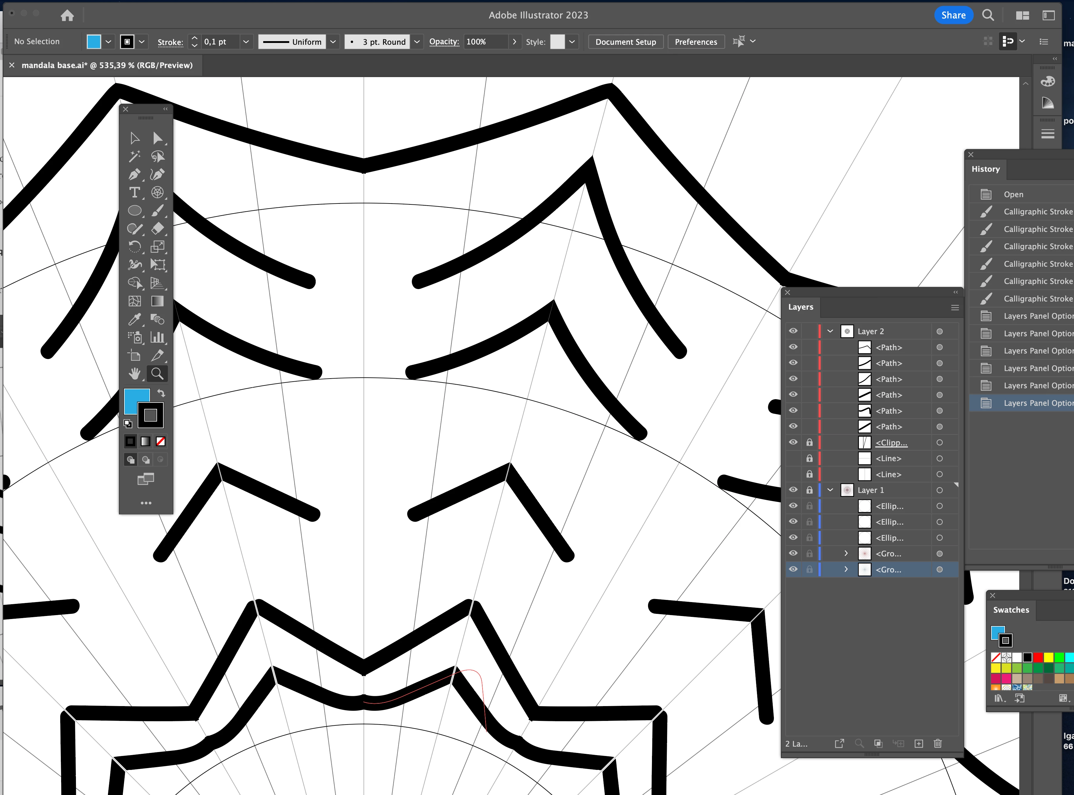

Hi. Anyone knows how to fix this? I have mandala grid under the painting as you can see and one layer of lines makes my mandala dashed. How to fix it, please help! Thank you in advance.

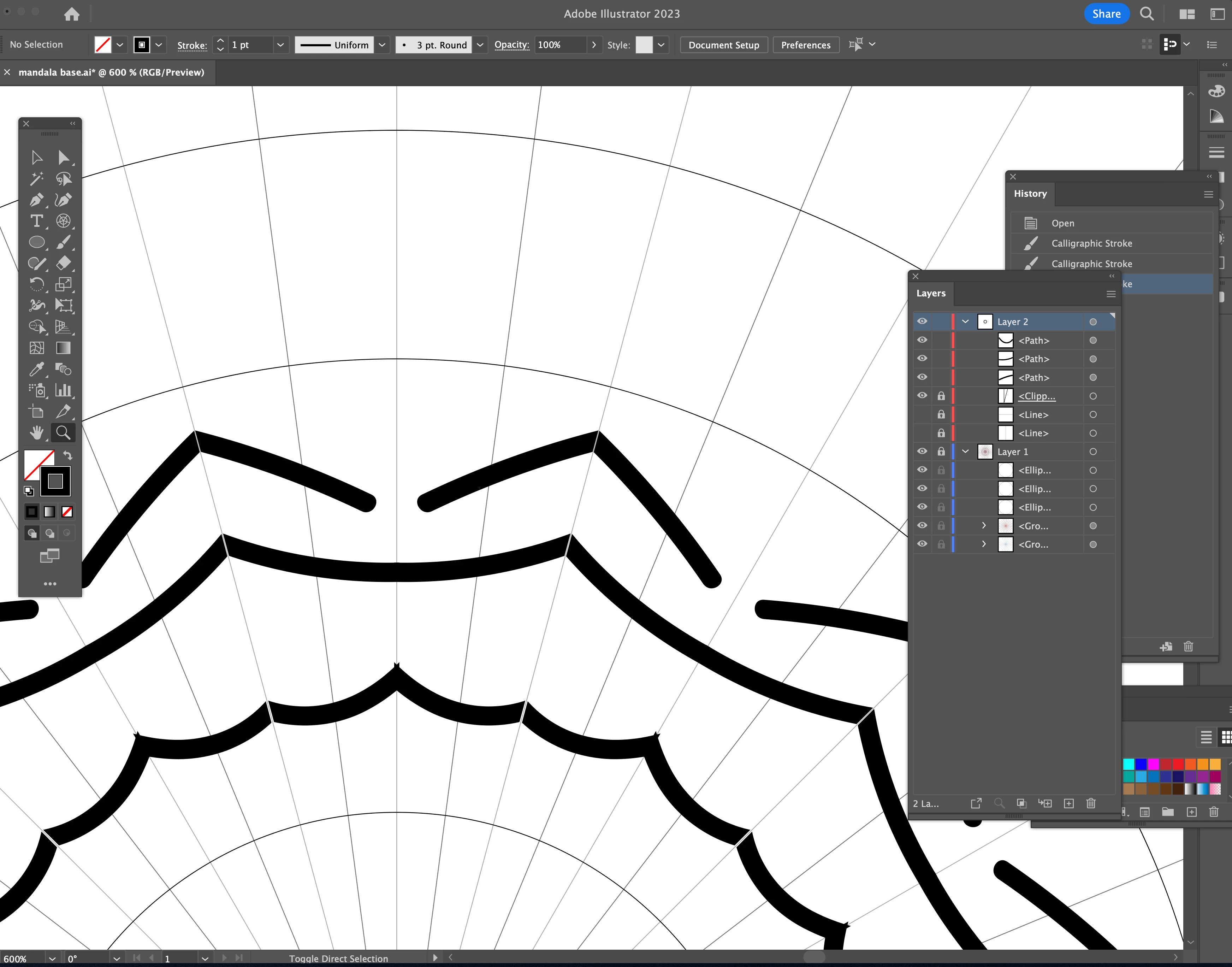

Are you talking about the radial lines being over the thick black lines? (Change stacking)
Or that your thick black lines don't join? (Use the radial lines to draw across the whole 12-rant* section width, then rotate)
* whatever that's called... 1/12th of a circle...
May 5, 2023
Thick black lines don't join. I draw with a paintbrush and blob brush.
Met1
May 5, 2023
Do you understand what the radial guide lines are for?
If you don't draw to the edge of that section, your lines will not "touch" when rotated...
But maybe I'm misunderstanding what you want to do...

Looks like some of the lines are not running under, but over the Mandala. The screenshot is blurred beyond recognition. Please embed screenshots in your posts.
Also: how exactly did you create the mandala?
May 5, 2023
I made a mandala by drawing lines and transforming them. Can you see it now?
May 5, 2023
The lines narrow as they get further from the center.
