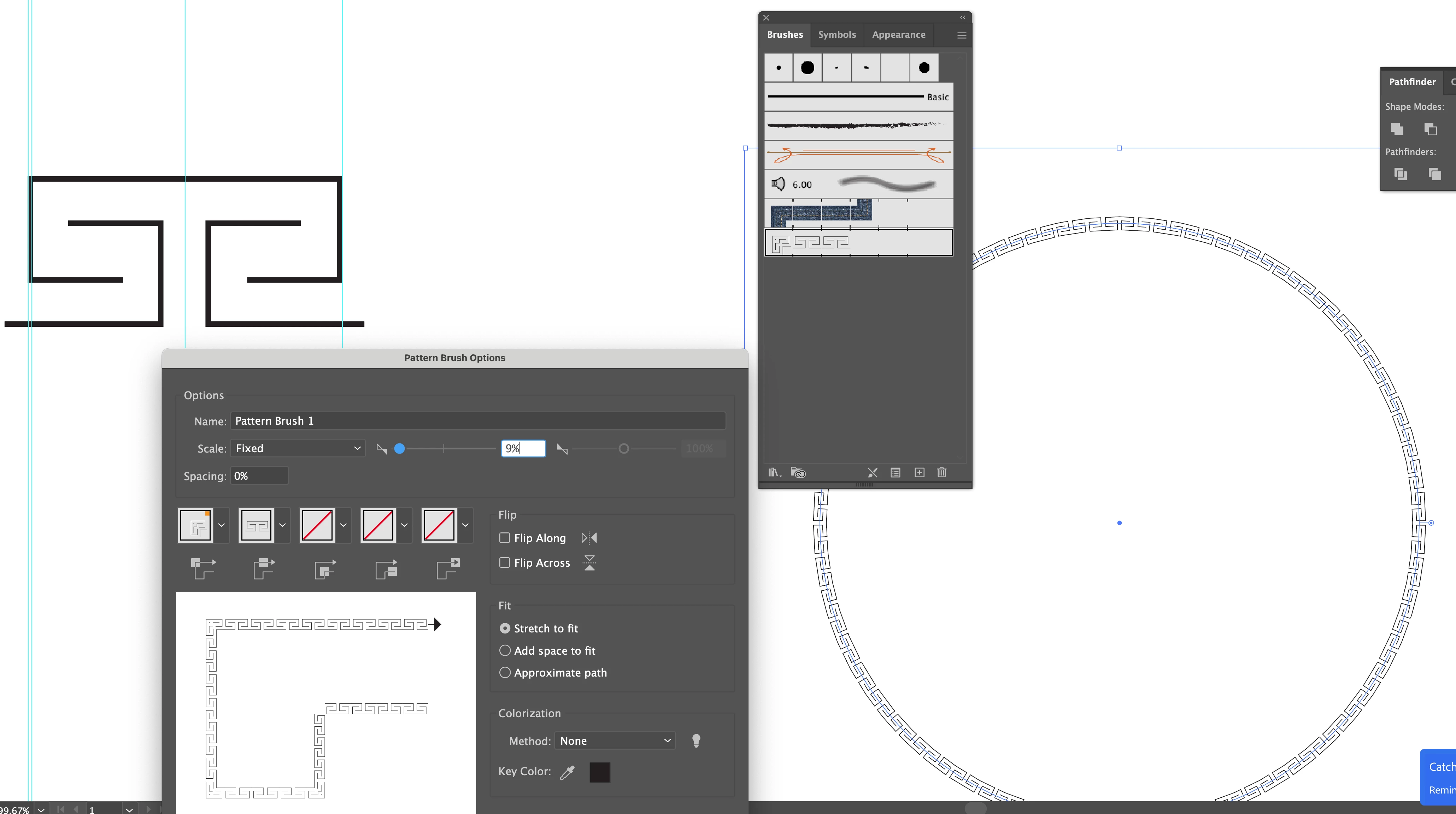

You can use the rectangle tool, then cut out the middle part of the bottom long side, then copy and rotate the copy by 180 degrees and move it downwards as desired, then cut the whole long side to split the copy, then reflect each half and move the two halves apart as desired.

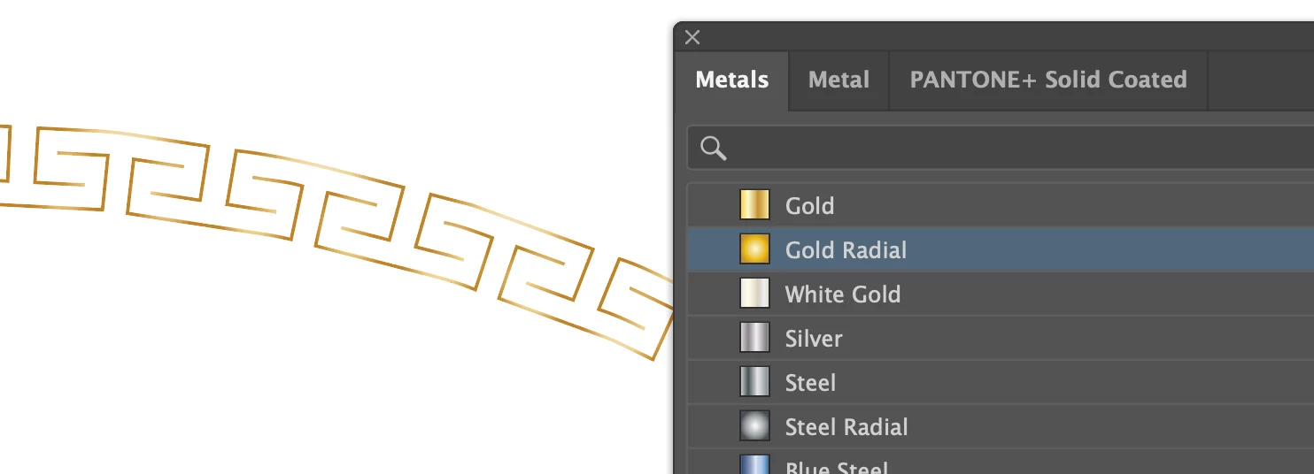

You can draw a segment of your pattern and create a new pattern brush from it. You then Expand Appearance and add the metallic effect to the ring.
