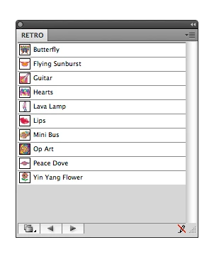

An AI template file containing all your symbols is fine… That will just be doc.symbols how you chop up that array into sub arrays would be down to you… I don't see how this is going to be any improvement over the symbol scrolling at the bottom of the library palette… See the back & forth arrows in the snapshot… I can jump very quickly between sets of symbols here…
