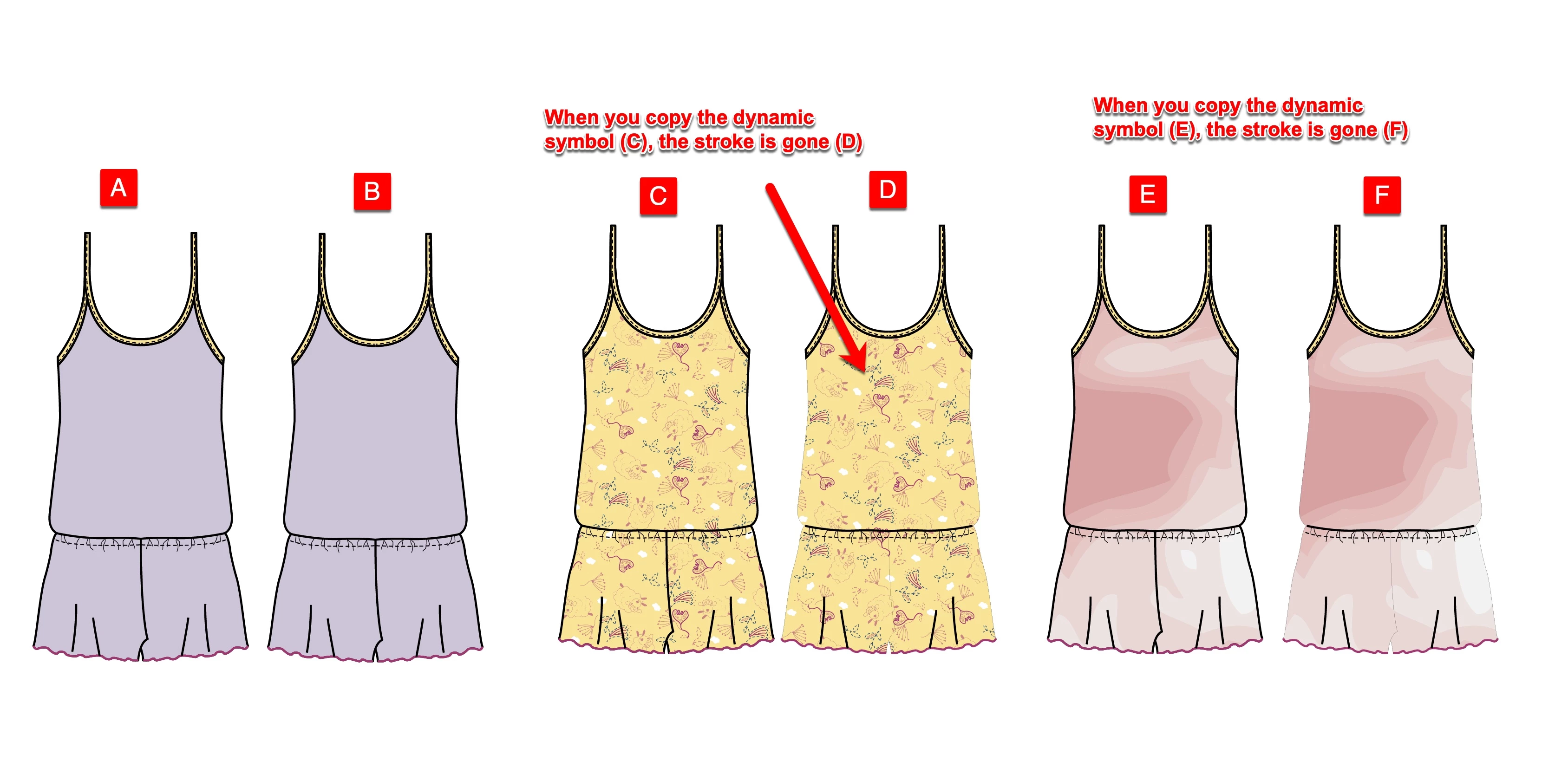

We use a lot of dynamic symbols in the fashion industry to make colorways and keep the link with the original sketch which is in black and white.
In Illustrator CC 2019 (23.1.1) and CC2020 (24.3) version on Mac and Windows, I noticed several bugs with the dynamic symbols:
When I copy a dynamic symbol (CTRL + C / CTRL+V), the outline of the copy disappears.
When I copy a dynamic symbol (ALT + Drag & Drop), the outline of the copy disappears.
When I copy a dynamic symbol using CTRL + C / CTRL + F, the outline of the copy is normal.
When I copy a dynamic symbol from one Illustrator document to another, the outline of the copy disappears.
Do you have any idea where this problem comes from?

Nov 17, 2020 4:55 PM UTC
At a second glance I can reproduce the behaviour when using different settings in the Transform palette.
It does not happen if you enable the Transform Object Only option in the flyout menu of the Transform palette, but the issue occurs if you turn on either the Transform Pattern Only or the Transform Both option.
Can you try and report/confirm?
Nov 17, 2020 8:22 PM UTC
Yes, i confirm that enable only the transform object option in the Transform panel solve the issue.
Thank you for the trick.
But when you want to move, rotate or rescale a pattern inside a shape, you have to turn the option Transform pattern again and then you loose the stroke again.
It's not suppose to work this way so i presume it's a bug.
What do you think ?
