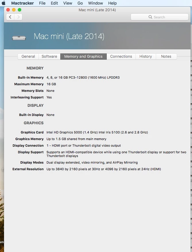

Wow - sorry, I wish I could help - but I'm not using Thunderbolt monitors, and I have no problem using 3 different monitors with 3 different apps, when necessary. I can't replicate your problem   I'm on a MacPro, sierra 10.12.5, and using an NVidia GTX 980 (4GB) flashed, so the connections are HDMI (2 monitors use DVI to HDMI adapters). It's got to be something related to the Thunderbolt issue. Looking up your model, it appears that it only supports what you want using Extended mode...

Please tell, which version of the MacOS are you using? That'd make a difference in the possible problems and answers.
Adobe Community Expert / Adobe Certified Instructor
MountJay
MountJayAuthor
July 7, 2017
macOS Sierra 10.12.4
