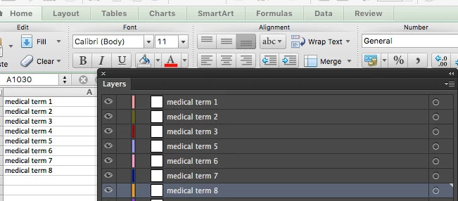

Make a text file, xls or doc into layer names in Illustrator
I'm doing medical graphics.
The doctor sent a spreadsheet with 1000 items and I need to draw them.
I would like to import his terms into layers, so I don't need to cut/paste 1K things.
Is there a existing script that can do this?
(I have almost zero coding skills)
Thanks!
Silly-V
Silly-VCorrect answer
December 15, 2015
Sure:
function LayersFromColumns(){
     var doc = app.activeDocument;
     var src=File.openDialog("Pick a single-column .txt file");
     if(src== null){
          return;
     var contents;
     src.open('r');
     contents = src.read();
     src.close();
     var layerNames = contents.split(/\n/g);
     var thisLayer;
     for(var i=0; i<layerNames.length; i++){
          thisLayer = doc.layers.add();
          thisLayer.name = layerNames[i];
LayersFromColumns();
This is very basic, so you actually have to remove the default layer in a new document, or any existing layers if you already had some- because this thing will just append new layers.

Silly-V, thanks! Works like a charm.

Oh yea, the excel file will need to be saved as a single-column .txt file first, too.
