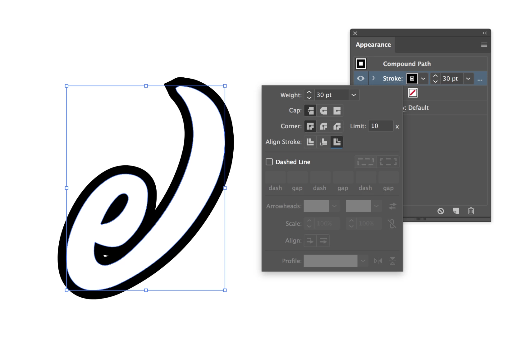

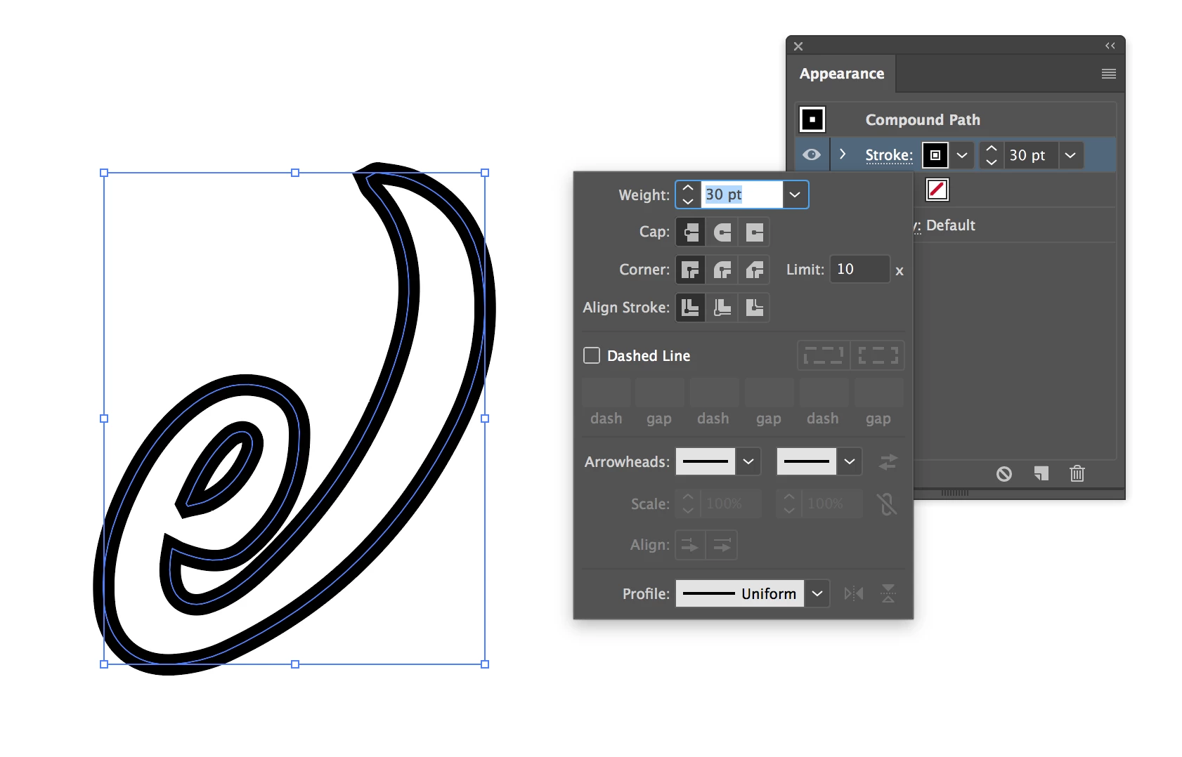

I want to increase the thickness of a letters outline, usually this would bring the outline inwards, how could I make it grow outwardly.. as seen in the pictures below.
Any input much appreciated, sorry if this has been discussed before, but had no luck finding an answer!
    Correct answer dannyg34842029
    If you select your object and open the Appearance panel (Window > Appearance) you will see that the default stroke alignment centers the stroke equally on the outside and inside of the vector line.
    The leftmost option aligns the stroke to the outside of the line.

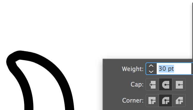

    You may need to use Cap styles and Corner styles are to define how the stroke looks:
    dannyg34842029Correct answer
    March 27, 2018

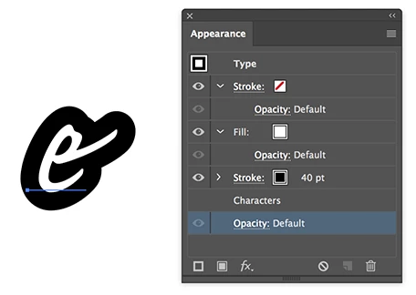

    You can add a stroke in the Appearance Panel and drag the stroke below the fill.
