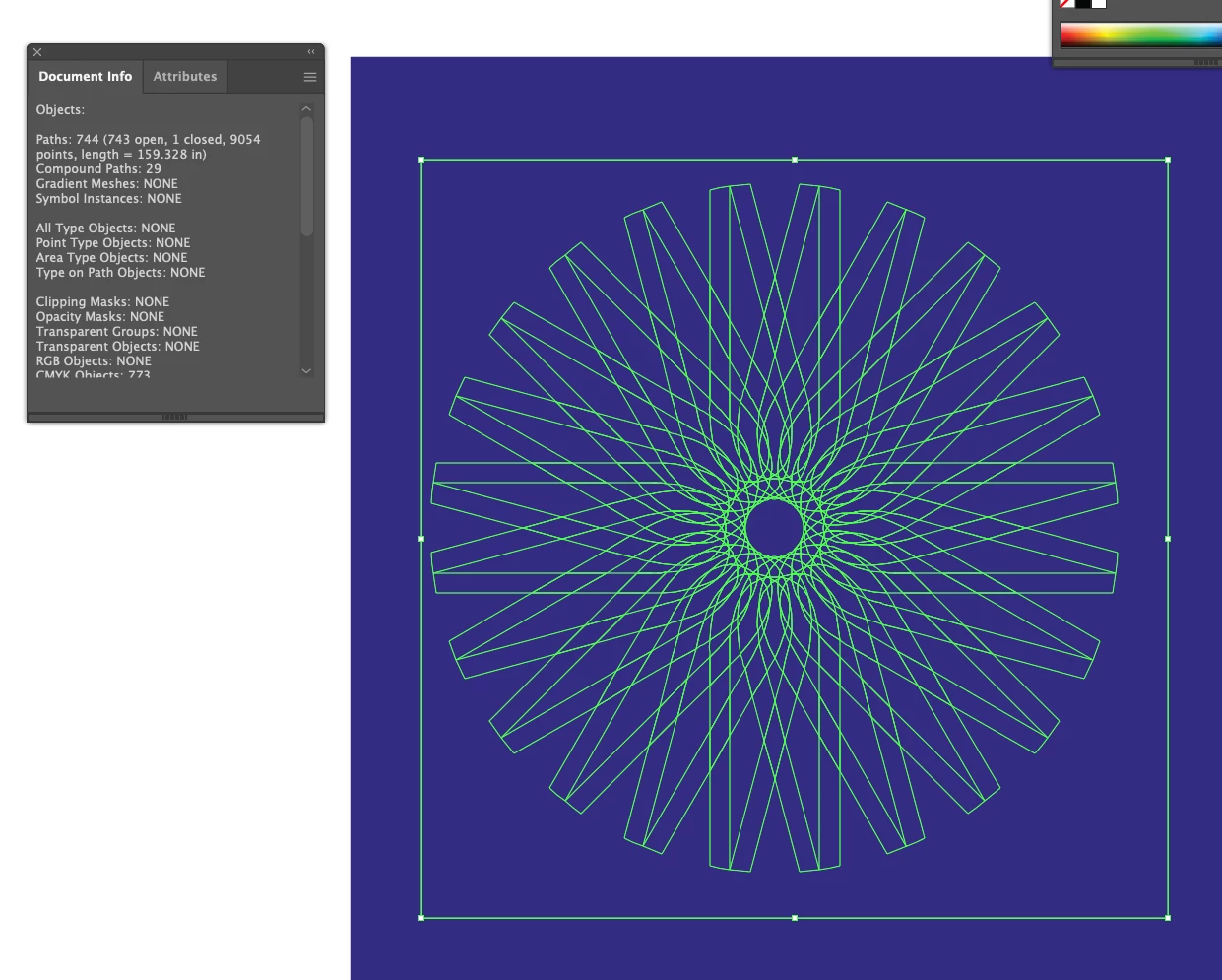

That did work, but the flattening operation seems to have created 743 open paths! I checked before and there were zero open paths.
That can't be ideal, right? Any suggestions?

That many open paths are definitely not ideal, I agree. Do you have a duplicate of the image underneath it that you weren't aware of? Overlapping the same image could potentially cause this.

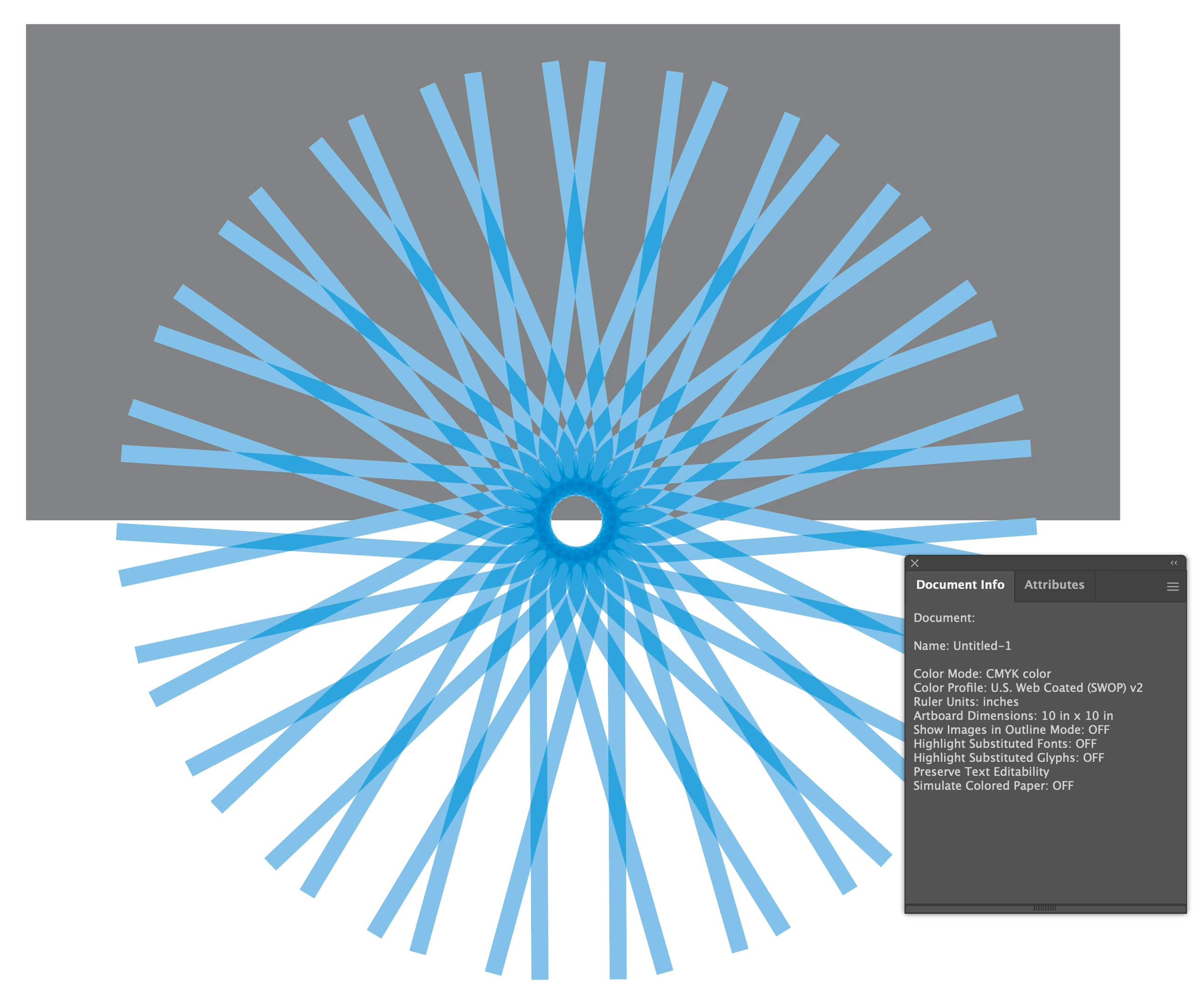

I tried replicating something similar, but wasn't able to get the open paths issue (image below). I didn't make any compound paths; whereas I see you have 29. Whether this creates the open path issue or not, I'm uncertain. If you can try it without all of the compound paths, it might help..?
Another option is to try closing the paths (maybe an option in Pathfinder?), but this could be time consuming.
