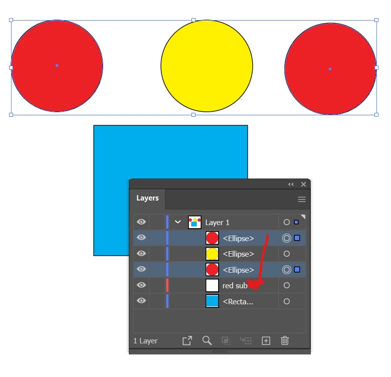

Mike_Gondek10189183
February 8, 2022
Command click on the objects names in the layer panel to highlight each of the objects names. Forget about the blue squares to right of radio button, unless you use those to know what layers to Command click. Then drag from where I show and drop.
