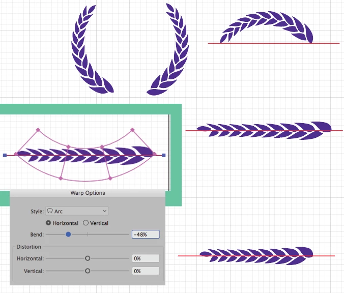

January 30, 2020
Anon, Hi.
If interested here is another method.
Like your example, it appears to be an Art Brush, applied a circle with stretch to fit, and then expanded.
I did the same here to test.
Now want linear.
Select or Lasso half of your art elements. Rotate if needed. I drew a red linear line as a visual.
Then used Object>Envelope>Make with Warp>Arc.
Play with those settings.
Expanded Envelope, slightly adjust the width to eliminate the stretching distort.
If your circle design is asymmetrical, then repeat the same process for the bottom half.
K
rcraighead
February 4, 2020
I like this approach, especially if you have a vector to start with. Great idea!
