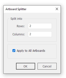

Kurt Gold
Aug 29, 2024 8:25 PM UTC
I've created a simple artboard splitter script.
You can download it here:
Artboard Splitter 1
