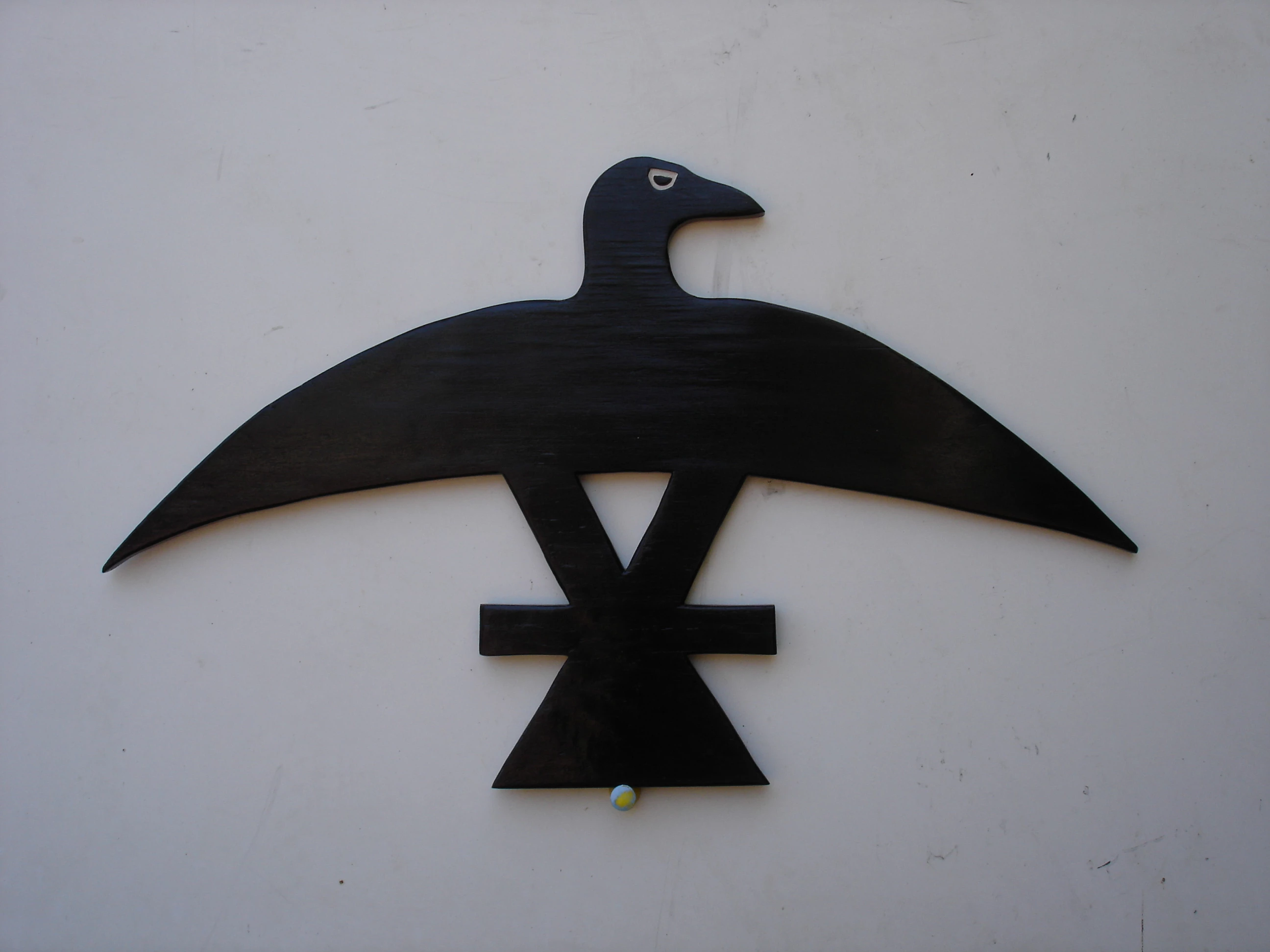

The first one is the photo of the original wood carving of the design.

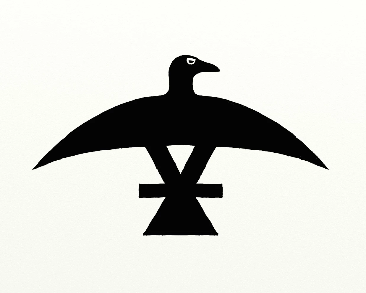

The second one is the tracing I did of it in ArtRage, I used the symmterical tool, but if one looks very closly or blows it way up, one can see pixelation or jagged edges.
I would like this symmetirical, both sides (the wings) the same except for the head, but vector without ragged jagged pixelated image so it can be scaled and used for different purposes, like business cards, brochure, website etc.
