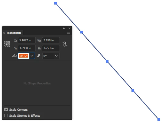

    Well since you already went through all that to find the length and angle, here's what you can do now...
    1. Choose the Line tool and holding Shift, draw a horizontal line of the prescribed length:
    2. Choose Object > Path > Add Anchor Points:
    3. Repeat Step 2:
    4. With the line still selected, enter 331.5° in the Transform panel's angle field (your angle was from vertical, so since we started horizontal, I added another 90°):
    5. With Snap to Point (and Smart Guides), turned on swap in your new line:

    Sorry, I mis-typed that. Your original angle + 90° = 311.5°
    My math was good, but my typing isn't.
