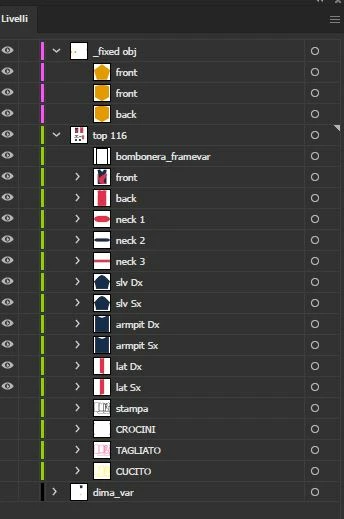

Here's the screenshot of the starting layers composition:

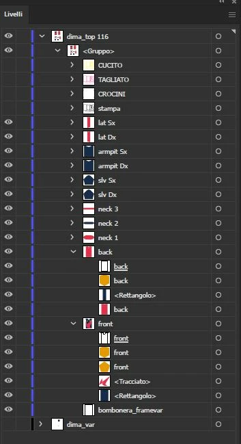

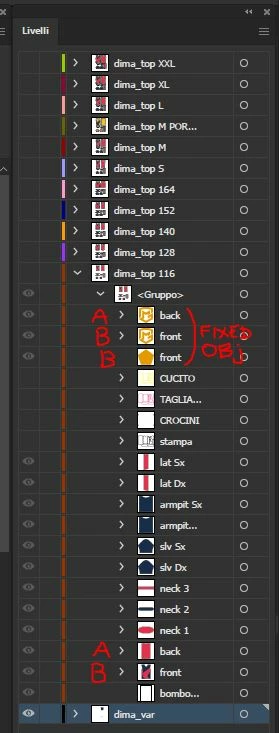

After the script it's like this:
I'd like if those fixed objects will be place inside the relative group.
So the groups of fixed objects named "back" will go into the group named "back", the ones named "front" will go into "front" and so on.
Note: every layers ("dima_top_X") will have the same items structure inside of it, whit the same names.
Is it possible?

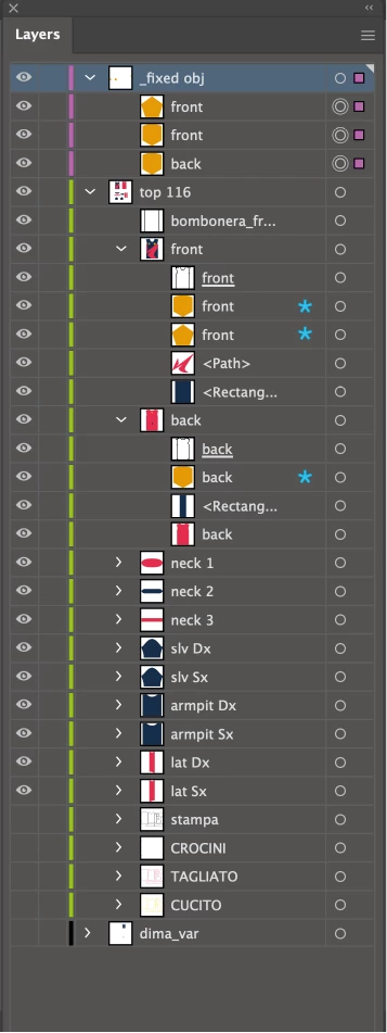

Here's a version that gets the template layer first and doesn't need a selection.
- Mark
 * Duplicates *template* items (all page items
 * in templateLayerName) into groups named to
 * match name of template item. For example,
 * an item "front" (in layer "_fixed obj") will
 * be duplicated into every GroupItem named "front"
 * and that has clipping mask called "front".
 * @7111211 m1b
 * @version 2022-12-06
 * @discussion https://community.adobe.com/t5/illustrator-discussions/merge-fixed-content-inside-specific-groups/m-p/13396929

Edit 1: added handling for hidden and locked layers and group items.
Edit 2: fixed bugs introduced in edit 1! Also added show results setting.

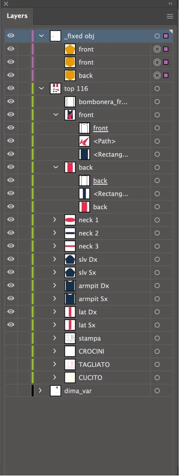

This is the ""before" layers panel:
Here's the "after" layers panel:
As you can see the elements inside the layer "_fixed obj" are now inside the groups in the layer "dima_top 116"
Of course those elements has to be duplicated into all the others layers's group.
So, if the element is called "front" it goes in every "front" named group in each layers.. and so on.
In this example there are fixed elements called "front" and back" only but it could happen that i have some fixed elements called "slv Sx" or "slv Dx"... the point is these elements have to go into the group with the same name contained in all layers (except "dima_var" layer but the script already prevent it).
The items or layers you see hidden have to stay that way.
