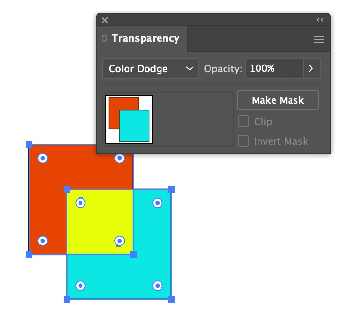

If I am understanding, where the two objects intersect, there would be a blended color of the two. You didn't actually divide the object into three objects, it was just an overlap. I am thinking that you used a blending mode of some sort. Is this what you are remembering?
