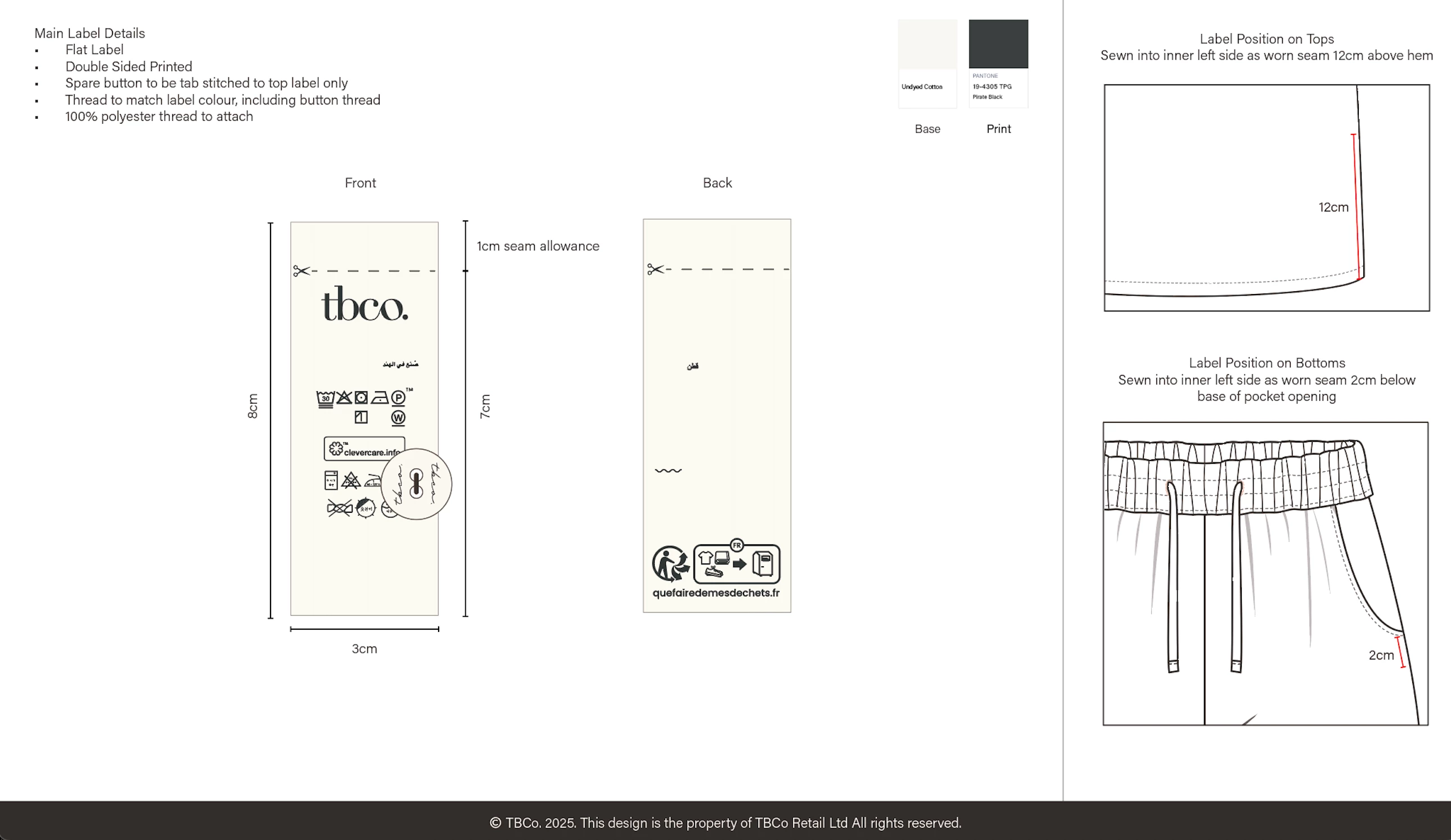

I have just updated to Illustrator version 29.6.1 and have found that text within text boxes in all files that I open is missing. My colleague opens the same files and can see all of the text within the boxes.
I have tried these help tips, but no luck. Reverting to the previous version was also unsuccessful.
Has anyone had the same issue?

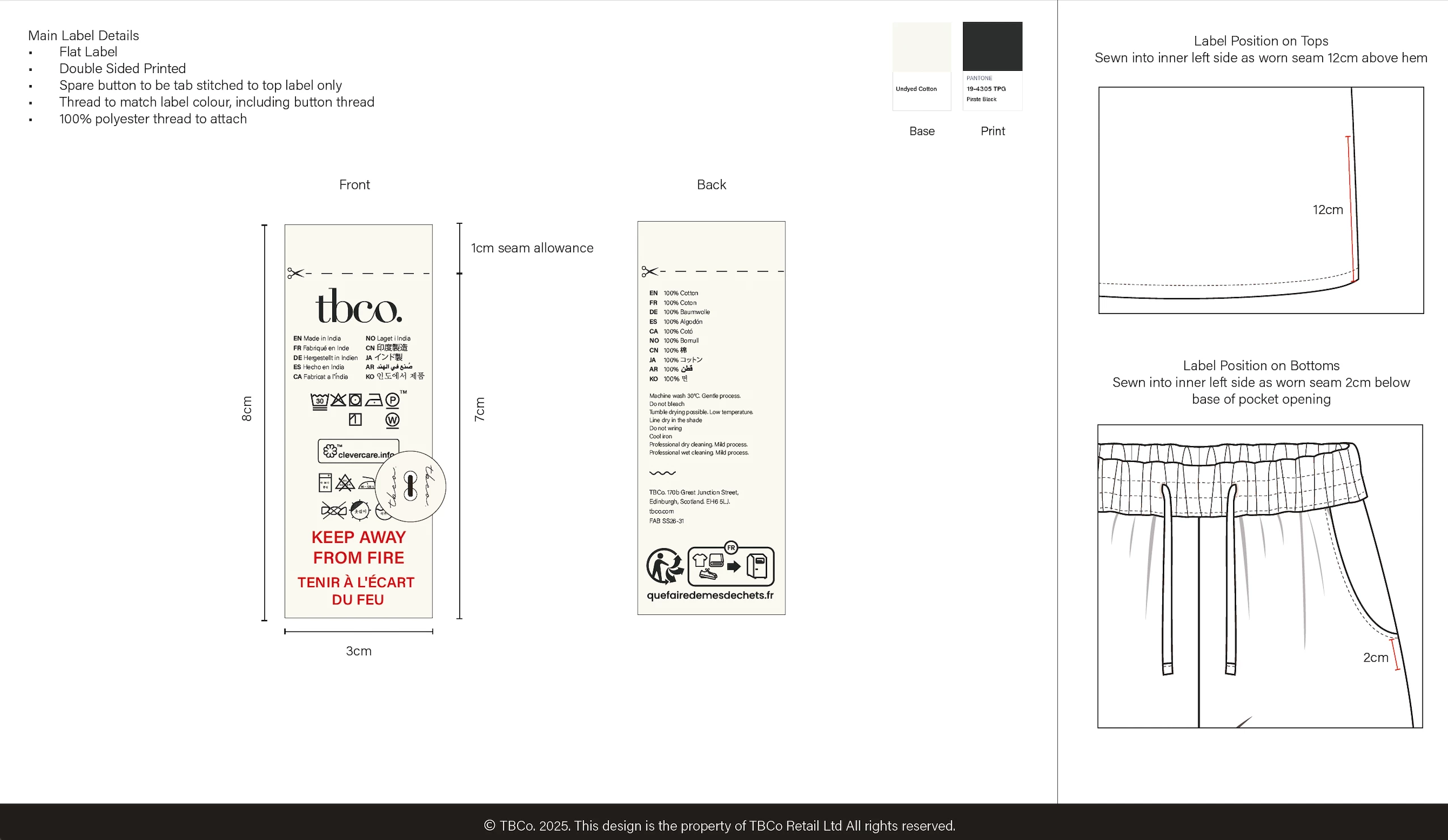

Sure, please see a screenshot of how the file should look, vs what I can see.
