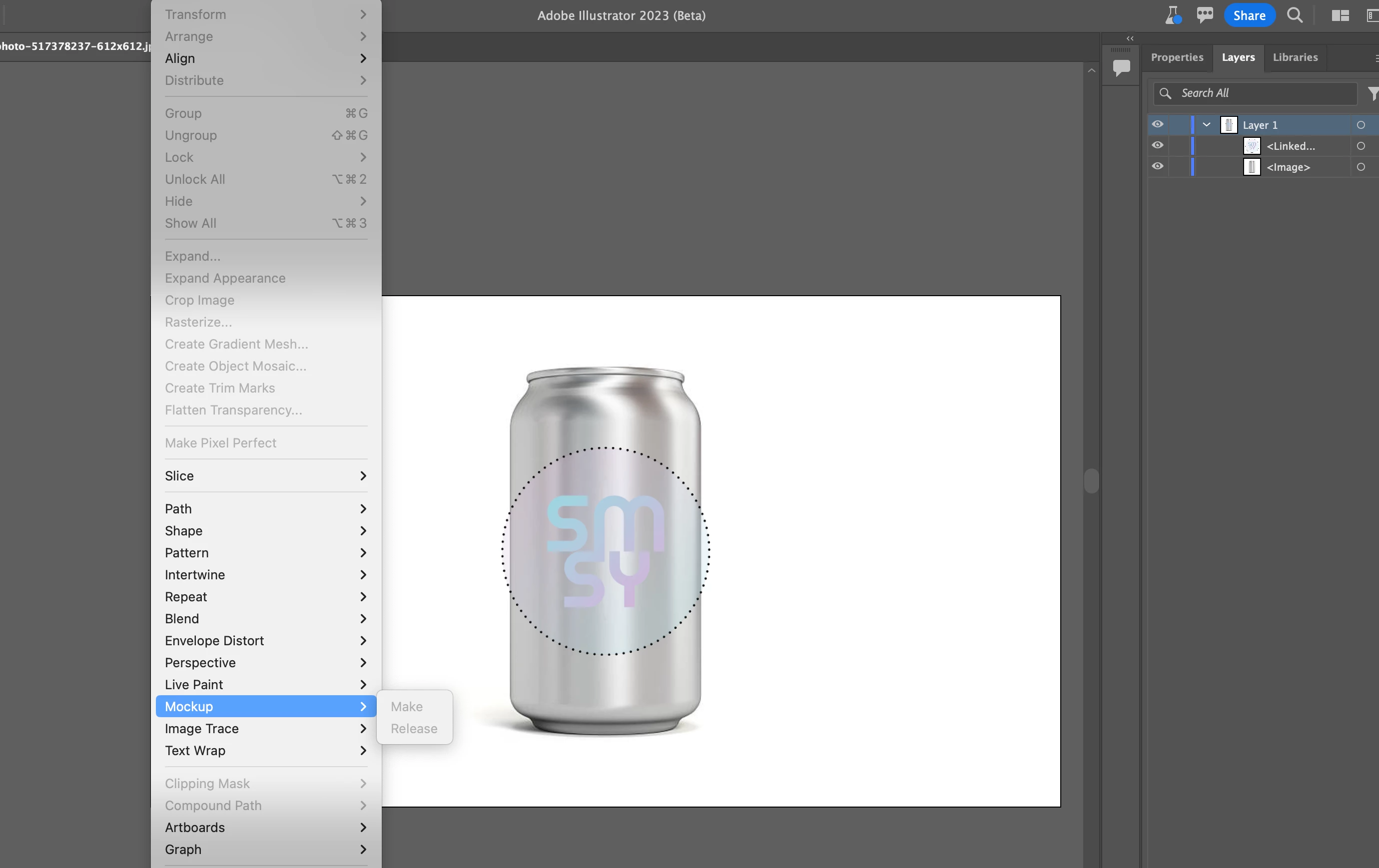

Hi all, I'm trying to use the new Beta feature "Mockup" but it's greyed out. I've followed the same steps as someone in a youTube video but mine doesn't work.
Any ideas of what could be wrong? Image type etc?
Thank you.

I figured it out. You have to create a mask on your object first. Kind of like how you would prep a logo for a decal or sticker with a cut line. Once it has a clipping mask on your entire art layer it will endable mock-up

You need to make sure that both your mockup image and your graphic are selected first, then go to Object > Mockup > Make
RongWroomAuthor
July 23, 2023
Thanks Jess. Yeah tried different combos with transparency, selecting all, selecting separate layers etc etc. worked once and then never again.
Can not work it out. Yours is working okay?
Jess Telmanik
July 23, 2023
They should all be on the same layer. Transparency shouldn't matter either (but could).
What file types are you using?
I've only tested it so far with jpegs and vectors and haven't run into this issue.
