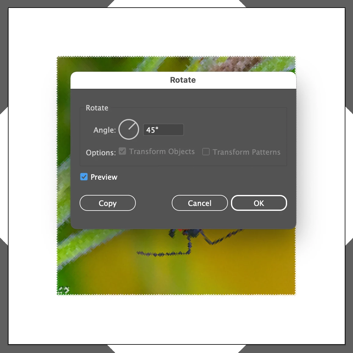

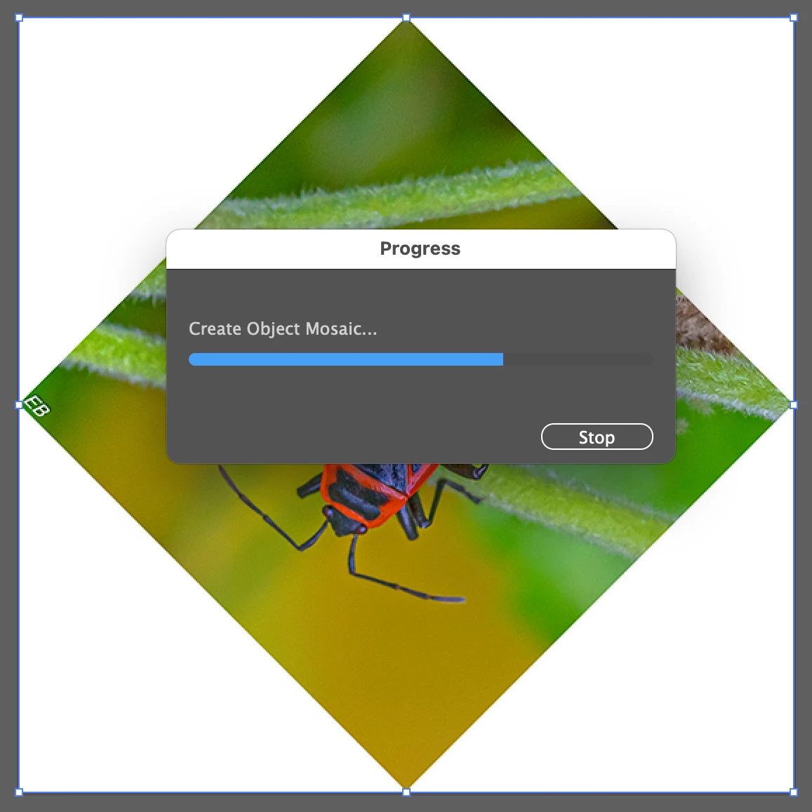

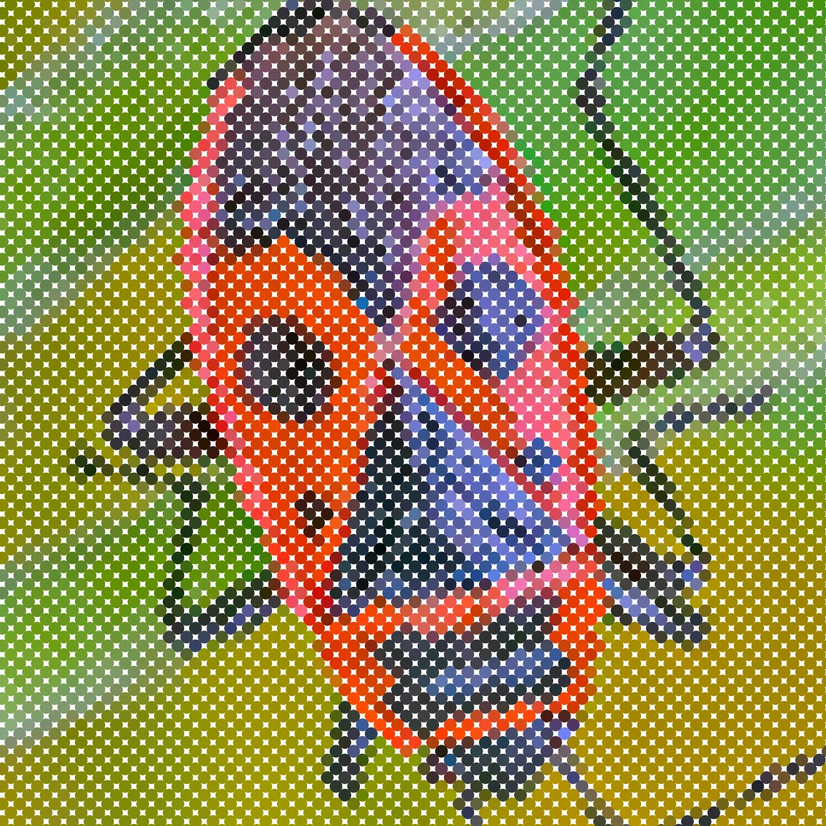

Another way to create a mosaic with 45 degrees dots:
Rotate the image 45 degrees and create an Object Mosaic.
Rotate it back and round the corners or replace the rectangles with a script to another shape.
November 11, 2023
Thank you Ton. A surprisingly simple solution! Perfect. Take care.

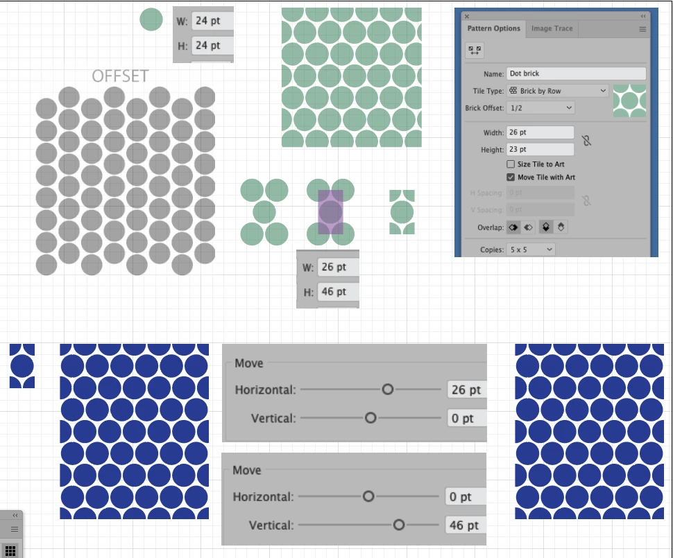

Like Ton said, here are the two methods I would use.
Shown in Green is a Pattern Swatch.
Shown in Blue is two Effects>Transforms applied.
K
