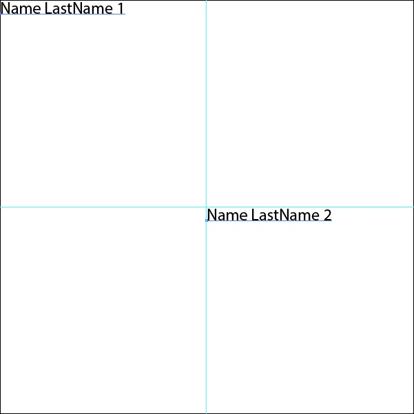

femkeblanco
February 8, 2022
This should give you two "point text" textFrames, the first at the document's top left and the second at the document's centre.  Note that y is negative.
var doc = app.activeDocument;
var nametext1 = app.activeDocument.textFrames.add();
nametext1.contents = "Name LastName 1";
nametext1.position = [0, 0];
var nametext2 = app.activeDocument.textFrames.add();
nametext2.contents = "Name LastName 2";
nametext2.position = [doc.width / 2, - doc.height / 2];
Is this what you get?  If so, you can work it out from there.
