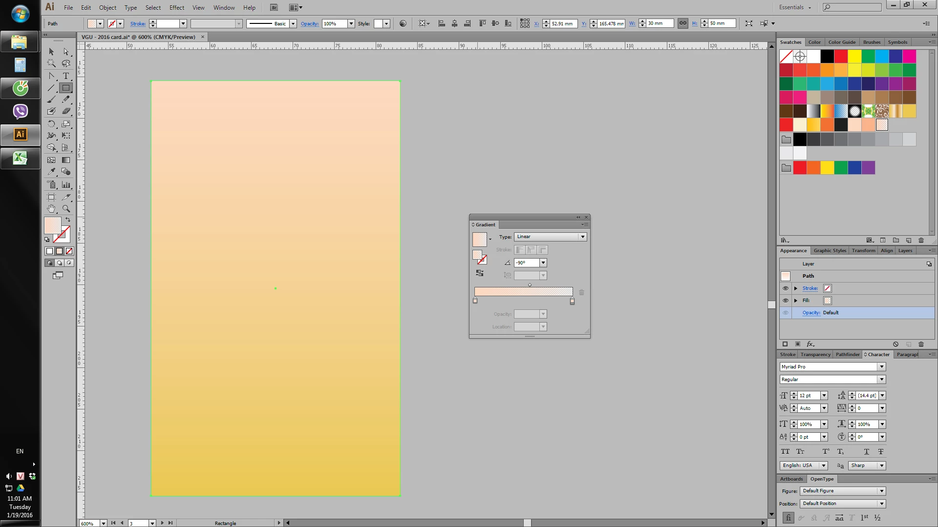

    Ryna Quynh
    January 19, 2016
    Help me, I set the color as below but the result is not, I don't know why. Even I chose the color and then create the shape. I'm using Window 7. Thank you so much
    Larry G. Schneider
    January 19, 2016
    You're applying the gradient fill at the Layer level, not the path as shown by the icon to the right of the layer.
