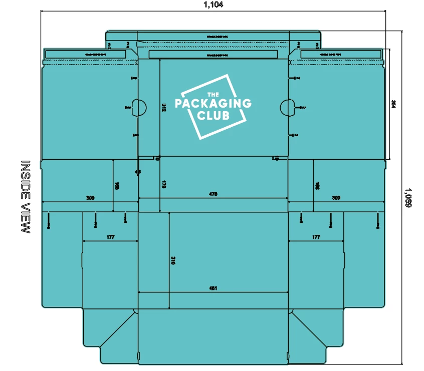

Having worked in repro and packaging design for many years, I used to create droplets and scripts to help speed up production workflows. I thought I'd share a very simple step by step method for converting a cutter guide provided by CAD from packaging manufacturers into a solid 3mm bleed shape.
Step 1
The supplied cutter guide usually comes with spot or unique colours to differentiate between which line is cut, crease, perforation, etc - you'll want to select the cut line - in this example it is coloured in a CMYK red.

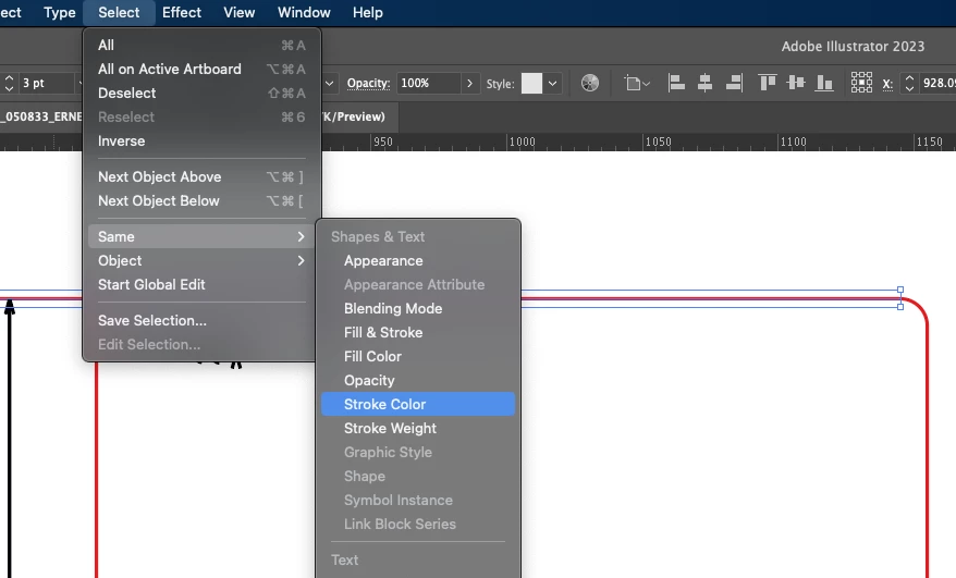

Select the cut line (CAD programs usually create segmented cutters, not compound paths that you can select), now go to Select > Same > Stroke Colour to select the entire cut path.

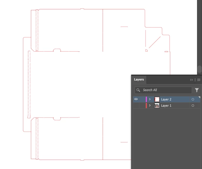

Once the cut line has been select, copy it CTRL/CMD + C, create a new layer in the layer menu, select that layer, then paste in place CMD/CTRL + SHIFT + V
Now you can hide the main cutter layer and you should be left with just the cut path outline on a single layer as per below.

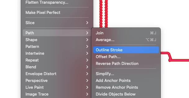

With the cutter selected, go to Object > Path > Outline Stroke

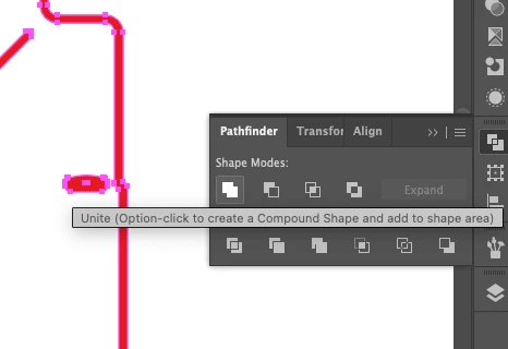

Then go to Pathfinder > click "Unite" (if you can't find it, go to Window > Pathfinder to activate the Pathfinder menu).
Step 6

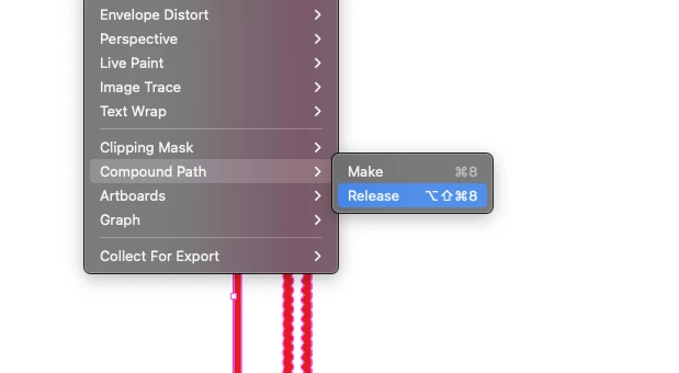

Go to Object > Compound Path > Release

Go back to Pathfinder > click "Unite" again, and you'll have a solid shape exactly with 3mm bleed outside of the cutter guide line center point.
