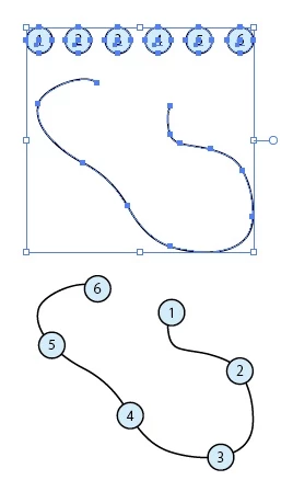

Dear all,
I need an Illustrator script for distribute a collection of diferent symbols along a path. The symbols should be distributed from the beginning to end of path and separated a proportional space each other. Additionally each symbol should be rotated pointing to a "look at" object.
Please look at the attached image for further info.

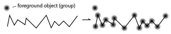

It needs these processes.
1. creates an array of symbols sorted from left to right by their positions
2. distributes them on the path
3. rotates them toward the target point
The 2nd part needs so complicated process.

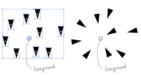

The 3rd part is relatively simple as follows.
function main(){
    var sels = activeDocument.selection;
    // gets the center of the foreground object.
    // the other objects are rotated toward this point.
    var point = getCenter( sels[0] );
    for(var i = 1; i < sels.length; i++){
        var t = getAngle( point, getCenter(sels));
        sels.rotate( t - 90, true, true, true, true, Transformation.CENTER );
function getCenter(p){
    return [p.left + p.width / 2, p.top - p.height / 2];
function getAngle(p1, p2){
    return Math.atan2(p2[1] - p1[1], p2[0] - p1[0]) * 180 / Math.PI;
main();

By the moment I'm going to use circles and arcs as paths so I guess the second process can be solved using your script "Divide (length)" to add anchor points to the path as much as symbols in the array of the first process.
Thanks a lot!

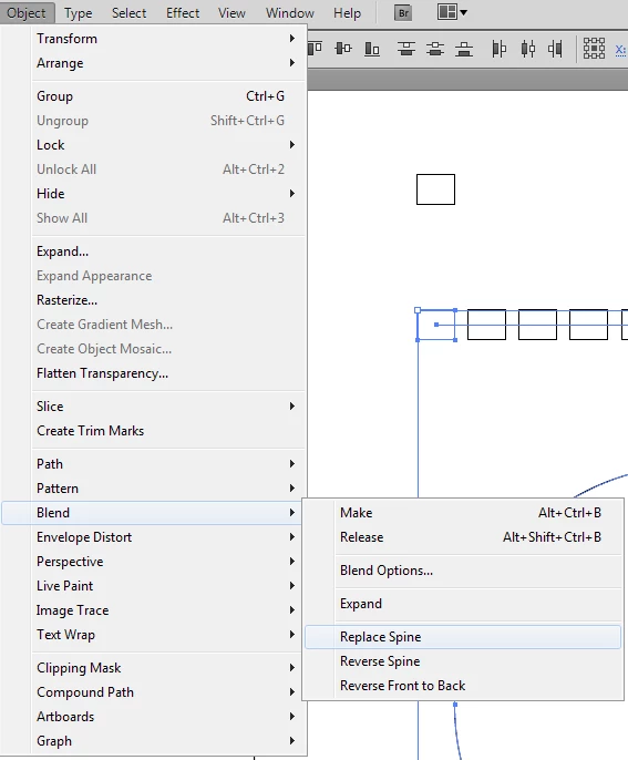

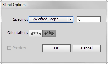

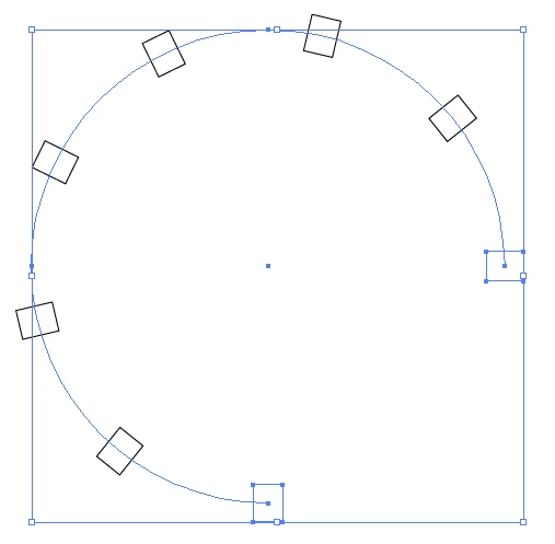

I know this is not what you are looking for, but here is what you could use when working with very SIMPLE paths (such as part of regular circle):
  • insert your object and its copy

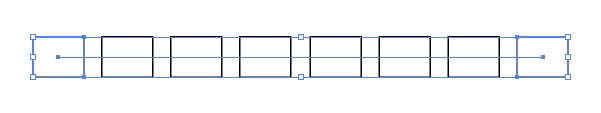

  • create intermediate objects using Blend Tool

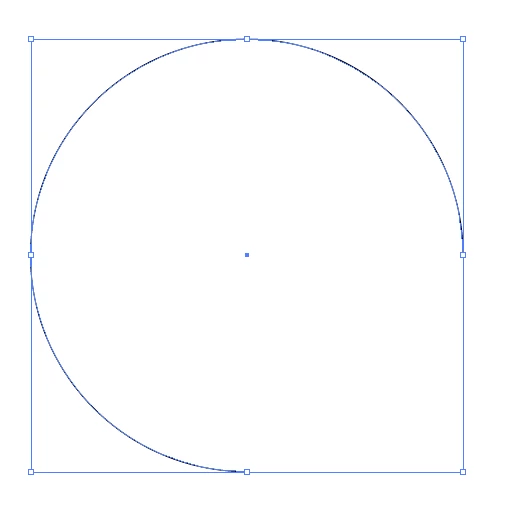

  • draw your path ( in my case this is 3/4 of a regular circle)

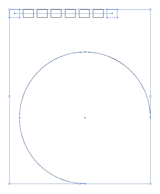

  • select your regular path and the Blend Assembly, go to Object > Blend > Replace Spin
  • the result
hope this helps,
Pawel Kuc, ccmutants.com

Feb 10, 2014 7:49 AM UTC
just to clarify: the Blend Tool works on symbols as well
tested with CS6 and CC...
