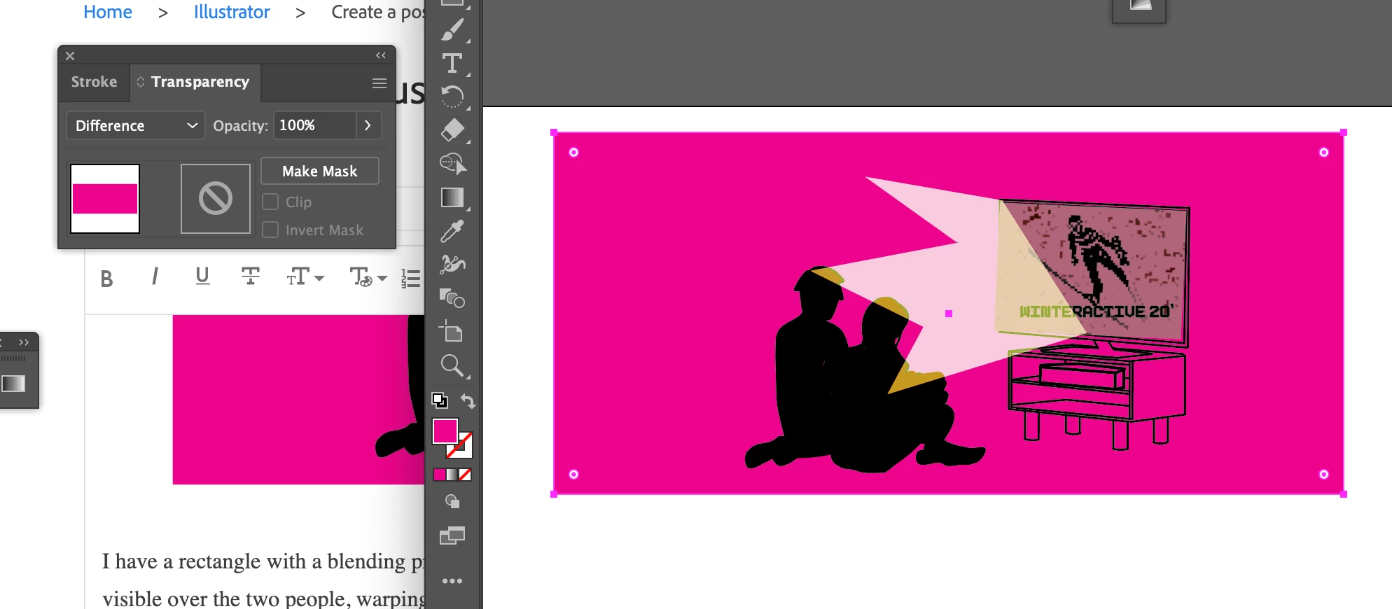

Hi all -- new to illustrator so I have a question regarding color masks (and masks in general). What I'm looking to have is a difference mask that only shows up over the layers and not on the white background. For example:
I have a rectangle with a blending property of "difference." What I want is for just this mask to just be visible over the two people, warping to their shape and potentially a few others. I've tried looking up tutorials but am at a loss, so any information would be greatly appreciated.
Clicking the "make mask" button just makes the color disappear. I'm not quite sure how to use that option.

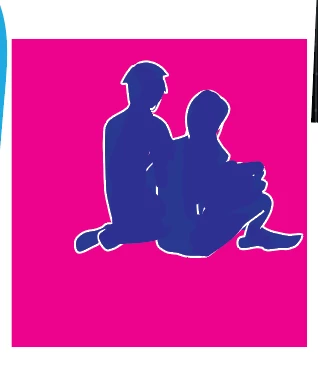

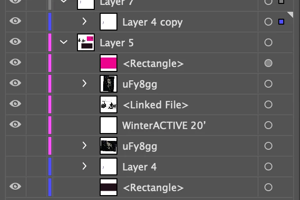

This isn't working, unfortunately. Or maybe I'm understanding wrong. If I put the shape of the people on top of the pink color, then that color correction layer is no longer working
The people are originally blue, and I like how the magenta corrects their color into a smooth black. If I put the blue people on top, though, then nothing happens.
I am also terrible at using illustrator, so it could just be me

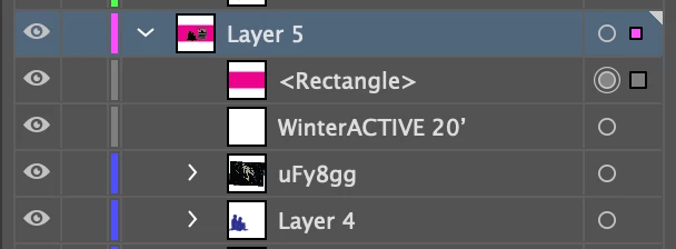

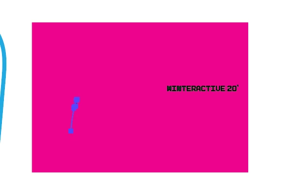

Turning it as a clip group does this though (im not even attempting to add the TV glow yet)
