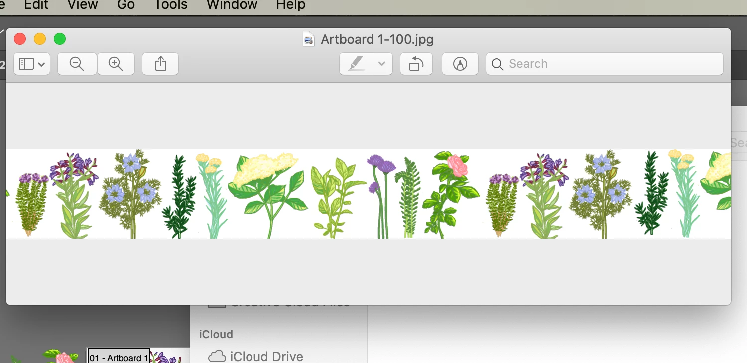

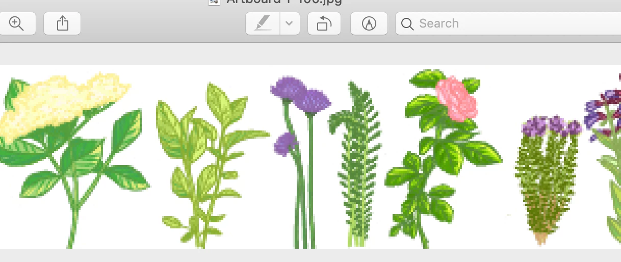

Hi!
I'm designing a web banner for a client's website. Dimensions need to be 728 x 90 (the standard I found through research).

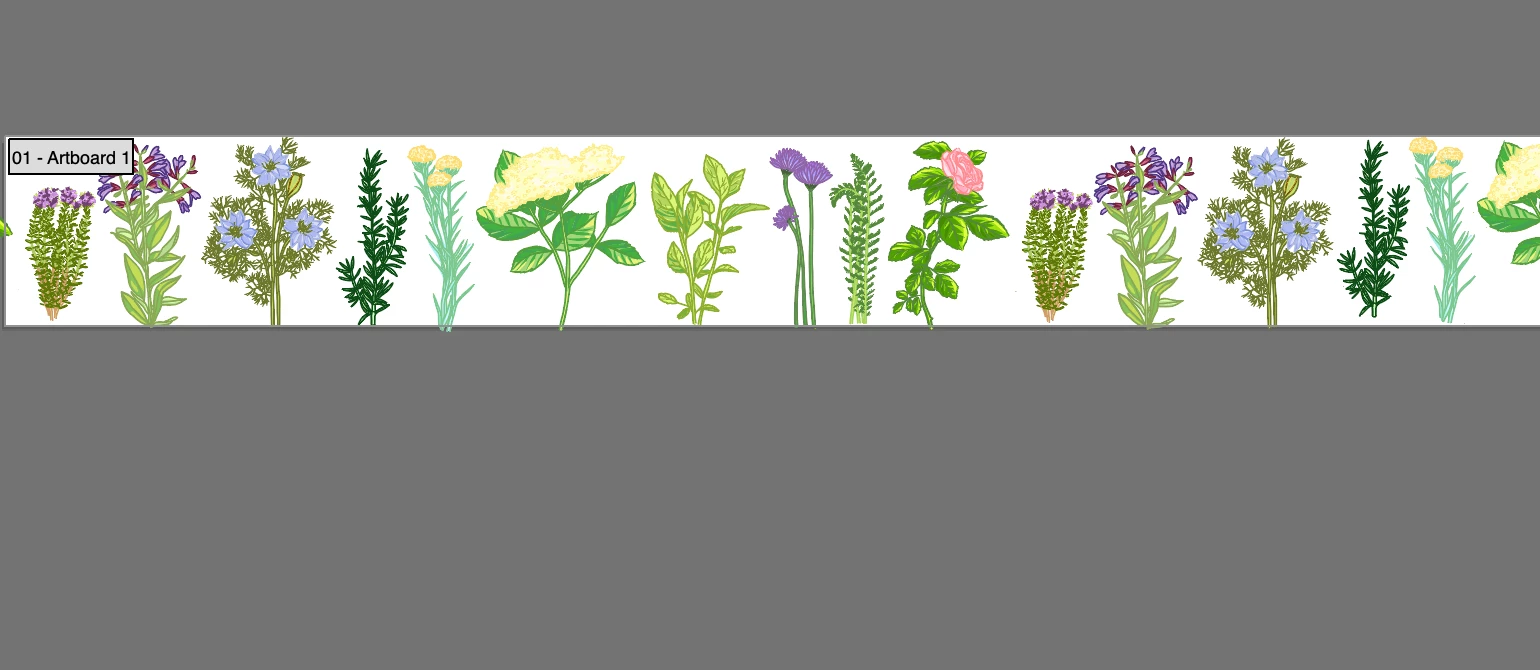

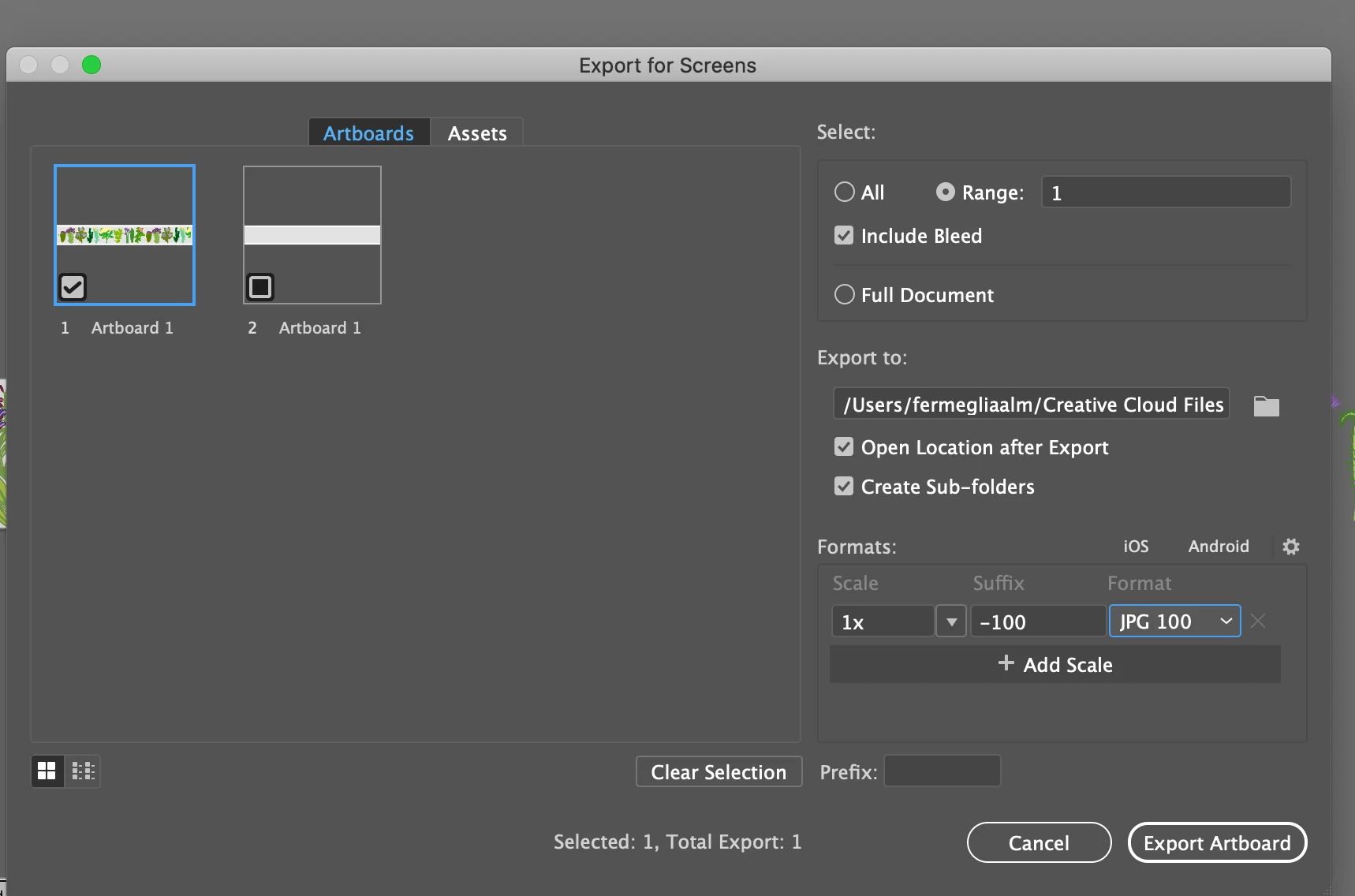

I created my design on the Adobe Draw app, opened it in illustrator, and need to save it for client's use.
But whenever I export (Export For Screen) and save as JPG or PNG, image is horribly pixelated.
I don't know where I've gone wrong, as I thought vector images could be used at any size.
Any help appreciated. Thanks!
-Alexa

In your Illustrator Preferences, is Antialiased Artwork ( I think it is under the General tab ) selected?

Yes, thank you. I'm aware of that, but even when viewing the image at its normal banner size after export, it is pixelated. Because the image is vector to start, I thought could be scaled to any size, then saved to a jpg or png with clarity. (Quite new to vector illo but I thought this would be an easy process).
Maybe that size is too small for an image that should stretch the length of the screen on a webpage. Would you recommend a different size?
