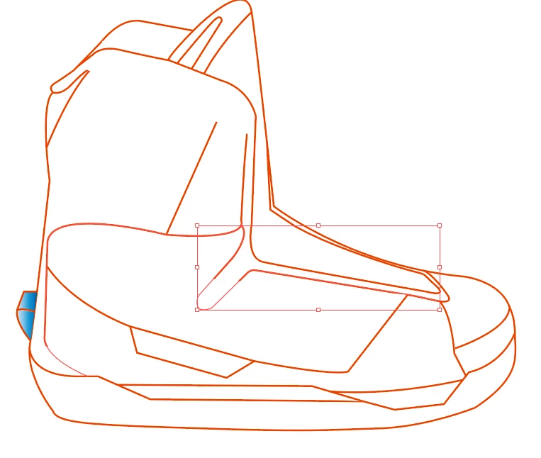

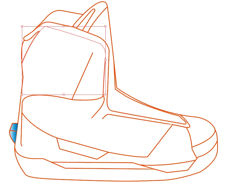

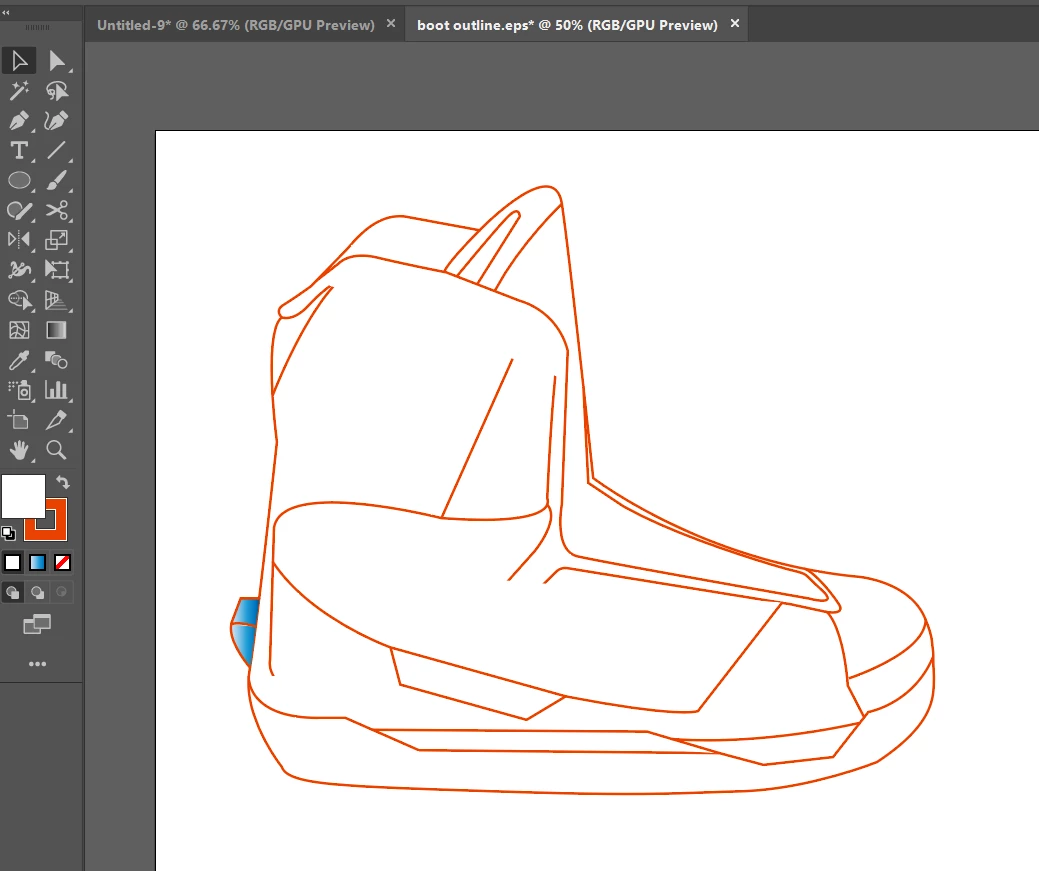

Below is what I see.
Here are some examples of what I've drawn that is somehow missing from the completed drawing:

Not only are you using a red stroke but I notice you are also using a white fill. Is it possible that you have drawn shapes, or even open paths, that have a white fill that are obscuring objects below?
If so, you could…
  • Select everything and set the fill of everything to "None".
  • Menu > View > Outline: This will show you your paths without any Strokes or Fills. Make sure you select "Menu > View > Preview" to get back to the default view.

You were right, I went back and found the paths with white fill covering up the other paths.  Took me a session with the adobe help people though.  Super helpful.  Thanks for helping out a noob!!
