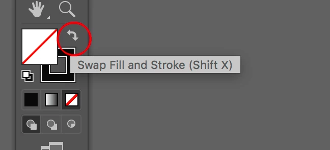

    You cannot make them work independaendlty, filll new pencil strokes wont help.
    So you want to have
    paintbrush - black stroke no fill
    pencil - black fill no stroke
    After switching tool use Shift X to switch fill and stroke, or click the double arrow.
    So you want to have

    With nothing selected double click the pencil to open the settings for the pencil. Check that the pencil has Fill New Pencil Strokes.
    The issue is that the Brush tool will use the Fill or Stroke to be just the Stroke colour. If you only have a fill so that you don't paint empty brush strokes it defaults to fill colour. So you will have stroke only as you say. I would suggest using hot keys to switch, it will not solve the issue but it will be less painful.
    B is Brush (notice how the switch to stoke instead of fill comes as you paint the first stroke)
    N then shift-X to go back to pencil (N for peNcil and shift-X to switch fill and stroke colour)
