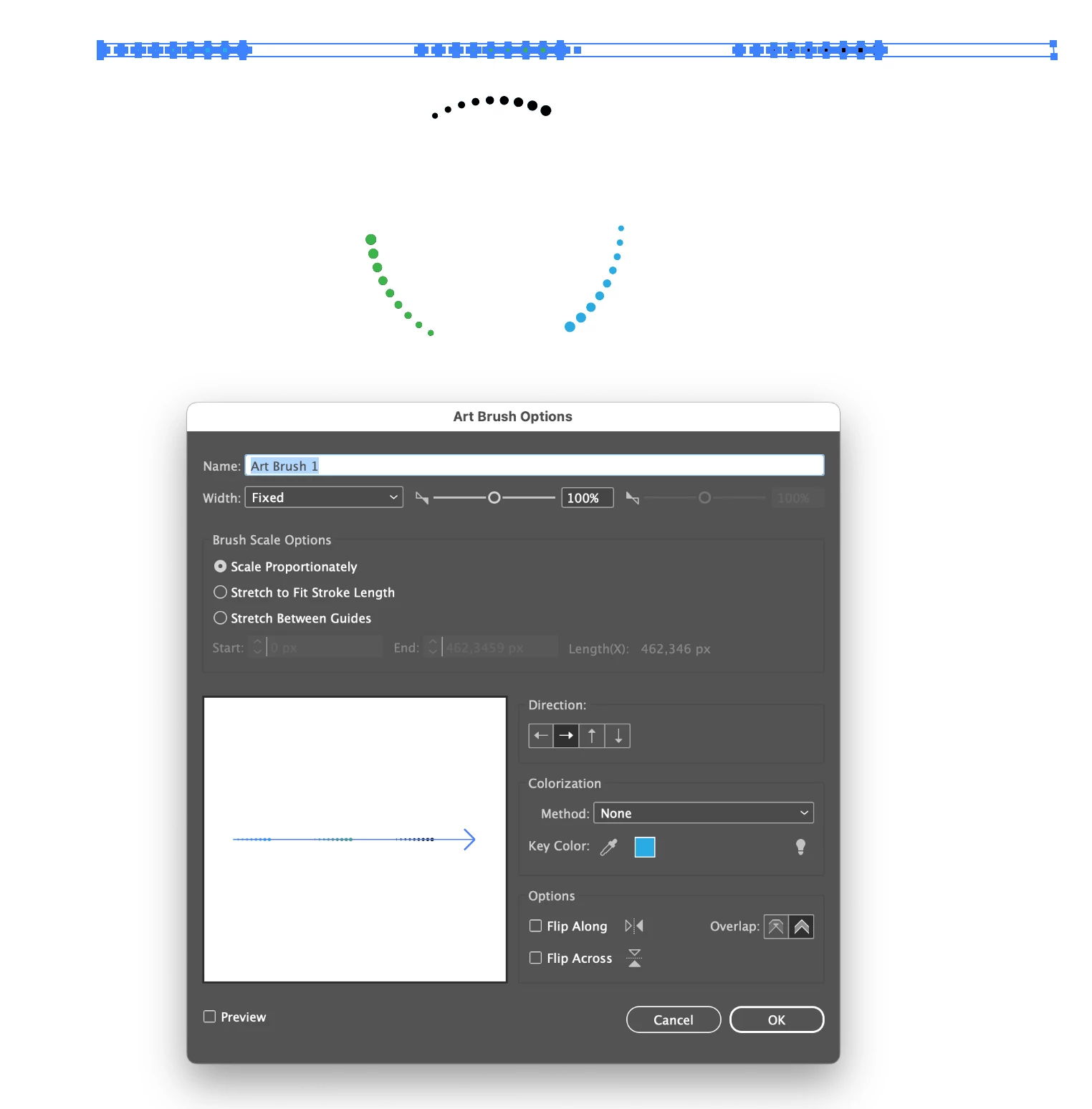

You may also tinker with a Pattern Brush approach in this sample Illustrator file.
Dots 1

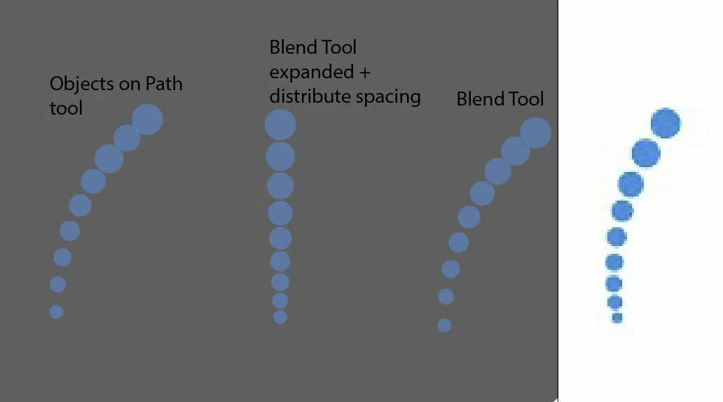

My problem remains, The dots have to be placed exaktly like in the above picture. I tried the Blend tool to get 9 circles but they overlap. i tried to expand the result and map the 9 circles onto a path. again, overlap. 😞 (see attached pic)
I´m sure there is a way to evenly distribute the circles on a defined part of the circle, but i lack the words to search for the tutorial that fits this problem.
Ton Frederiks
January 23, 2026
The distribute spacing should work after expanding and ungrouping the blend to avoid overlap.
PROVINZ
PROVINZAuthor
January 23, 2026
maybe i was unclear, you can follow my steps from right to left. If i expand, ungroup  and delete the round path between the dots in the left result, and then click distribute spacing the cicular shape of their positions is destroyed.
Plus, it would be a destructive method.

If it must more look like your image, you could create a brush with a background rectangle that defines the space between the groups of dots.
January 23, 2026

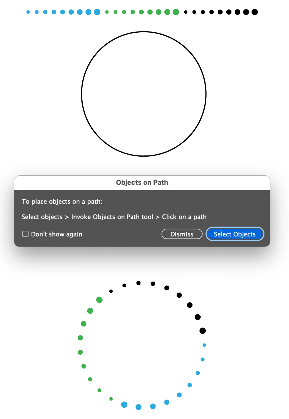

An Art Brush might distort the circle shapes a bit. What about breaking the large circle shape apart in 6 equal segments and then using the Objects on Path tool to apply the three groups of circles to three different segments of the large circle?
Ton Frederiks
January 22, 2026
If I understand your problem correctly, you may want to use the Object on a Path tool.
