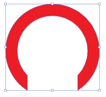

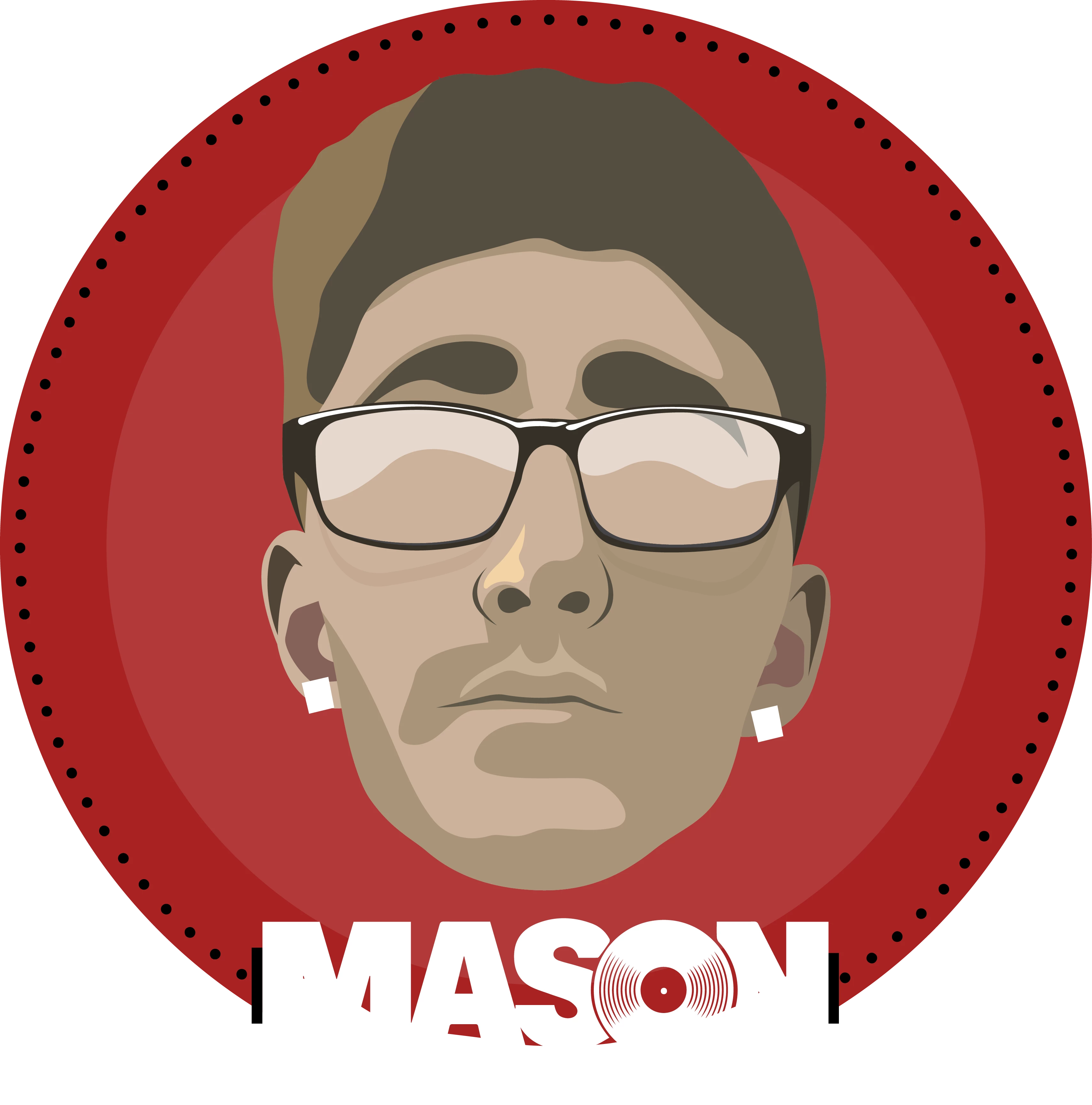

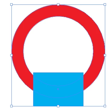

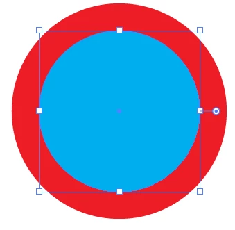

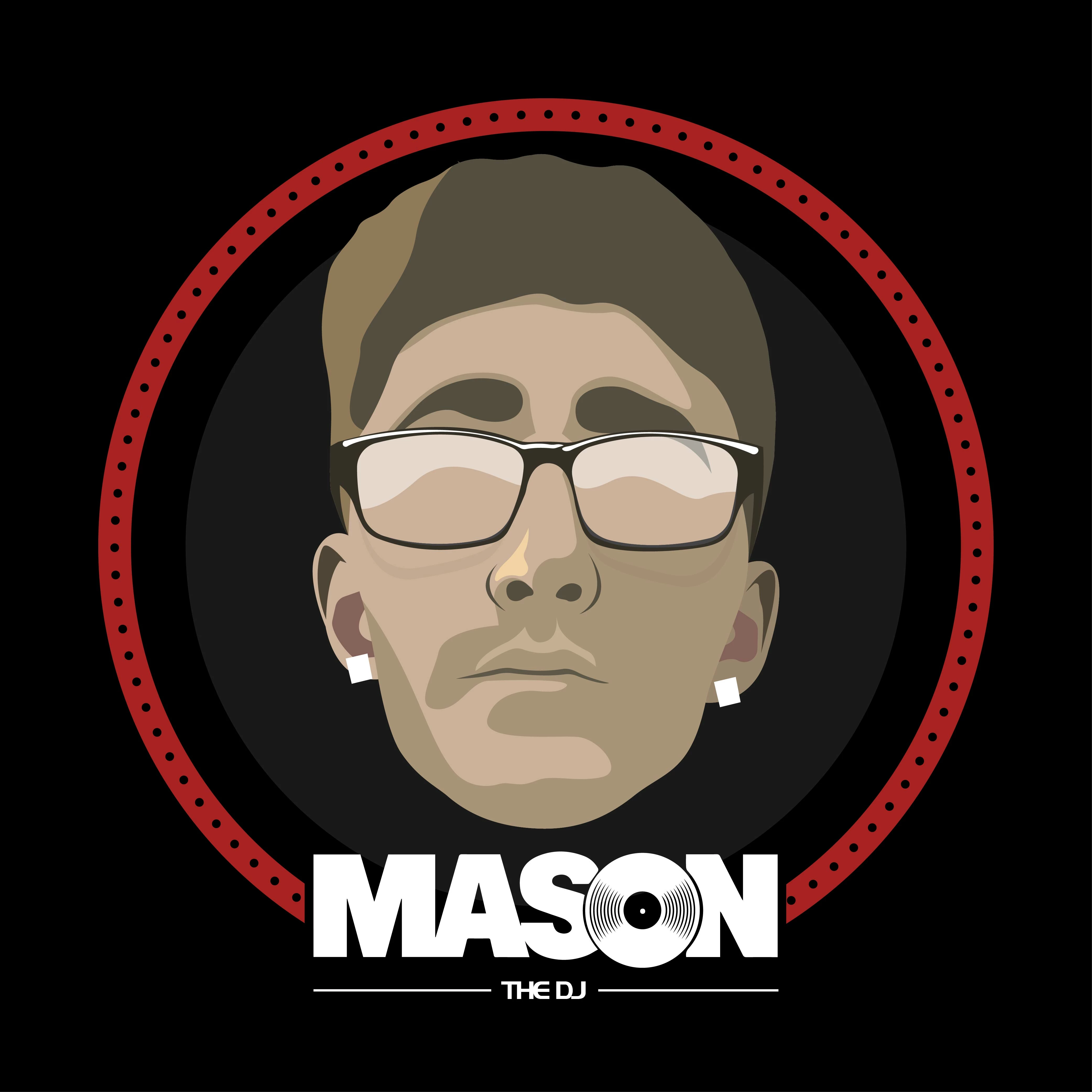

I want to make this a transparent logo so no matter what background color I put it on it will work.  As shown below, I have a filled in red circle, and over that is a filled in black circle, and over that one is another filled in circle with the opacity lowered.  My problem is the filled in black circle.  I need that to be erased so if the background was pink, inside of the circle would become pink.  But, when I delete the inner black circle, the red circle is now showing in place of the black one (shown in 2nd pic).  Basically, I want a red ring around the outside with no fill on the inside.  But another problem I am having is that I want the ring to be cut at the bottom where it says "MASON THE DJ", to create some space from the "MASON THE DJ" and the ring (like how it is in 1st pic).  In the 1st pic I didn't cut the ring, I placed black rectangles near it to create that effect, but I need to cut it completely instead of using the rectangles.  For some reason I cannot cut the ring.  When I try to erase it, it just pushes the circle in, but doesn't actually get rid of the piece.

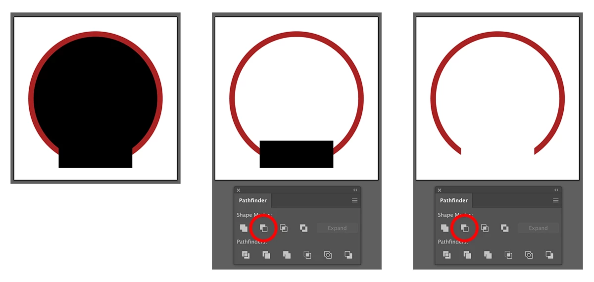

Select the red circle and overlapping black circle. From the Pathfinder panel select the Minus Front option.
Select the red ring and overlapping black rectangle and select the same button.

As far as cutting out the center of the circle, you could either use Pathfinder or Shape Builder.

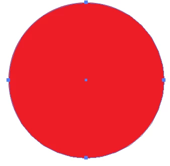

Starting with a circle:
Drawing another circle on top of it.

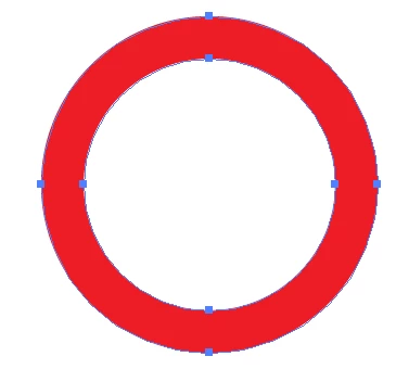

Select both circles. In the Pathfinder panel, click on Minus Front.

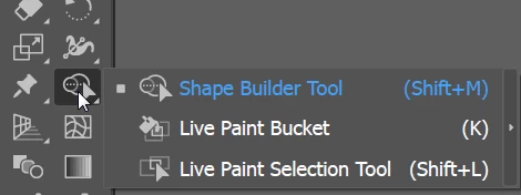

OR, you could choose the Shape Builder tool.
Hold down Alt or Option and you'll see a minus sign next to the icon for the tool. Click the area you want to delete.

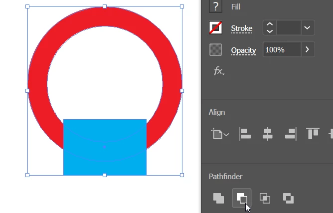

To remove the bottom piece, you can use similar technique.
Draw a shape over the area you want to delete.
Select both objects and either use Pathfinder Minus Front or hold down Alt/Option with Shape Builder tool and click the object you want to delete.

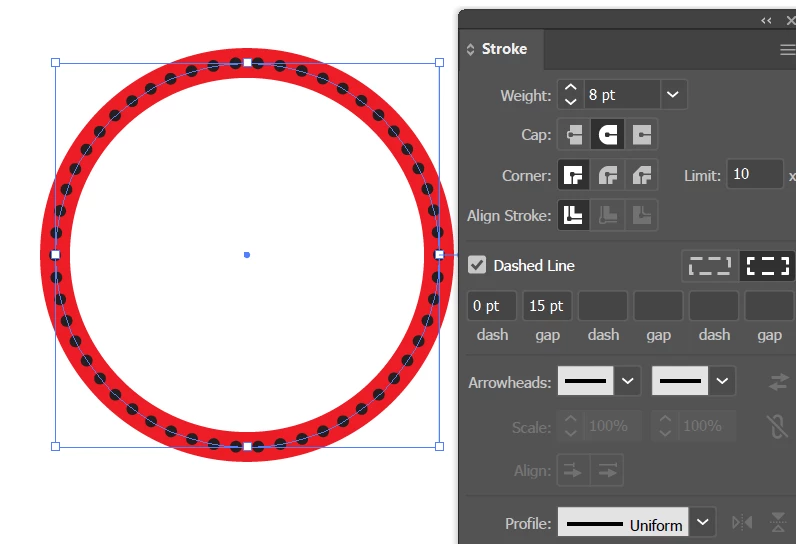

Thank you very much.  Another question, how would I punch out the black dots that are inside the red ring to also make that transparent? The dots are a Path by the way, not sure if that matters.  I tried selecting the red ring and selecting the dots and clicking Minus Front, but it didn't work.
barbara_a7746676
March 3, 2019
Did you make the dots using a dashed stroke with settings like this -- round cap and zero dash?
If so, next step is to select the dotted stroke and choose Object > Path > Outline Stroke.
Now you can select the dots and the circle and use Pathfinder > Minus Front.
