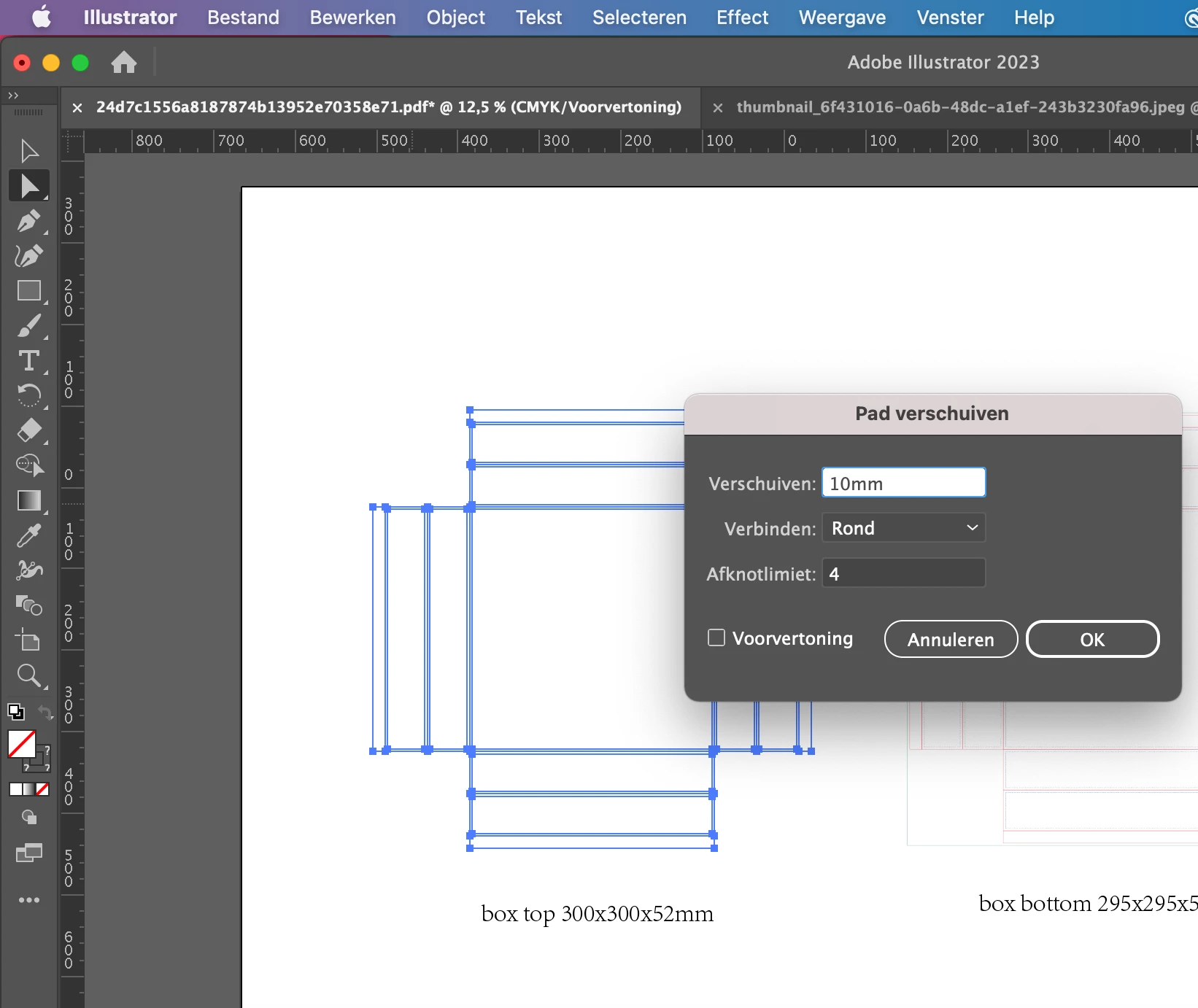

I'm currently working for the first time on designing a cover / package box for a board game using a template in Illustrator. I've been following a YouTube tutorial, but I'm encountering difficulties. In the tutorial, they mention creating an outer bleed/offset path and using the Shape Builder Tool. However, I'm not getting the same results as shown in the tutorial.
I suspect that the issue might be related to using a different template than what was used in the tutorial. Unfortunately, I need to use this specific template. Can anyone provide guidance on how to best utilize this template for designing the board game?

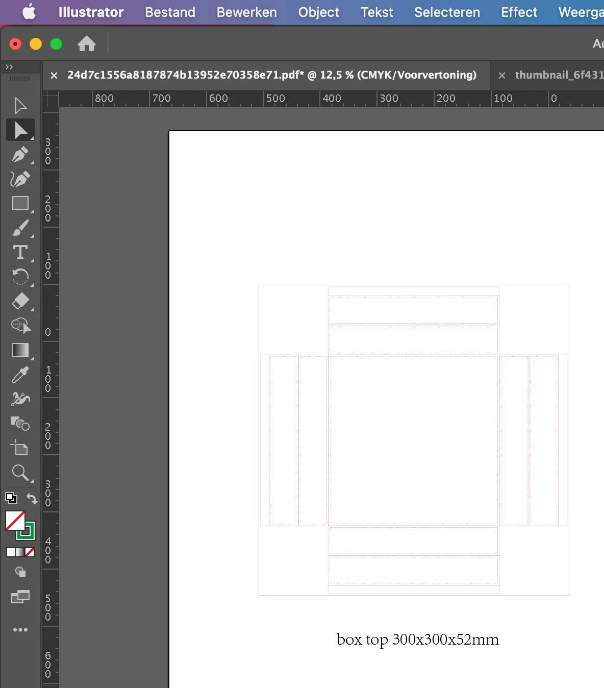

This is my template that I have to work with:

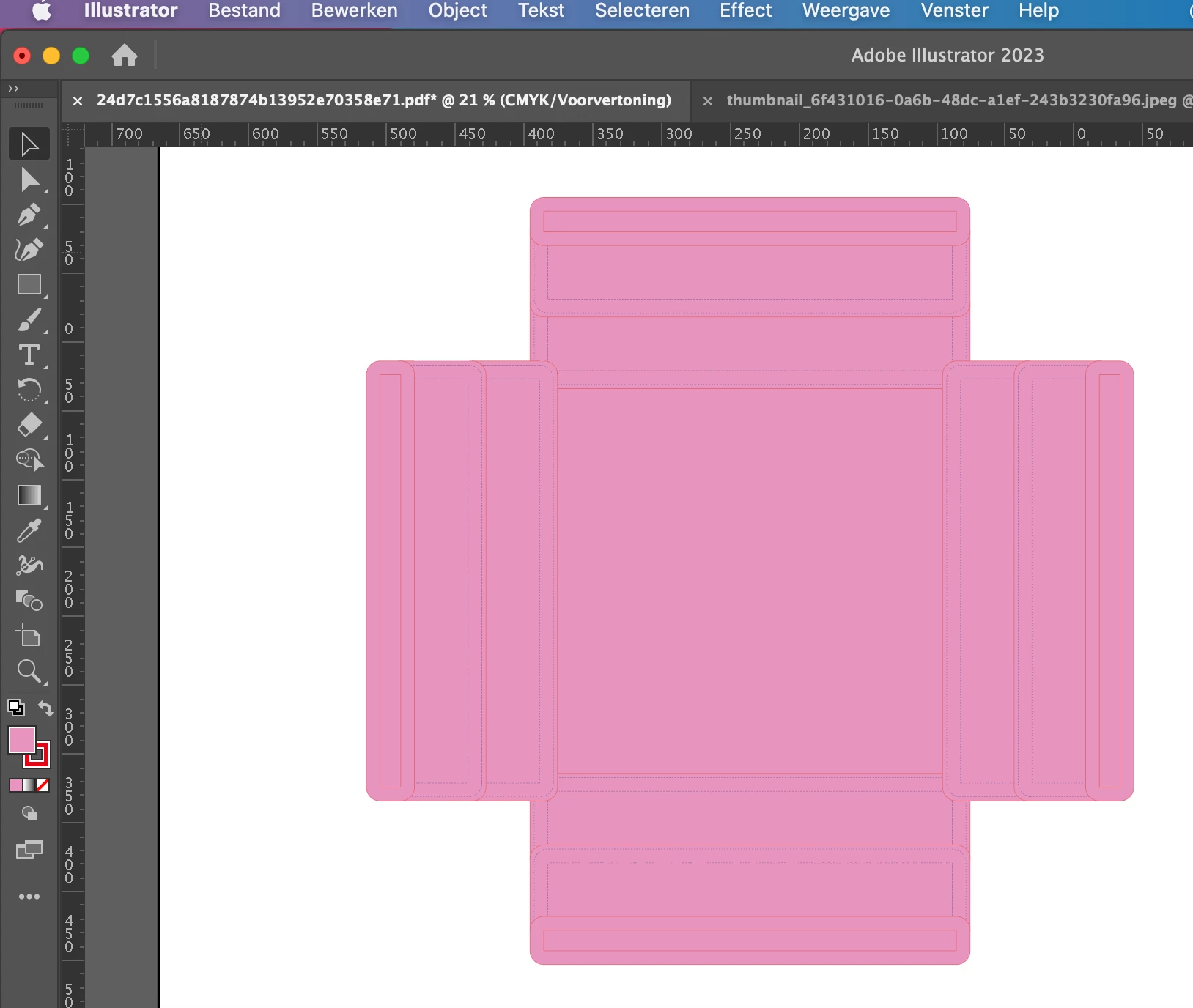

And this is my outcome (is this good?)

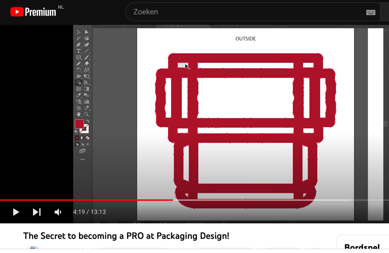

And this is the design of the YouTube tutorial that I'm following:

I'm really not sure what they are doing in that tutorial.
When you unite all your pink shapes (using the Pathfinder panel), then you should end up with the same result they have.
You made a copy of the original dieline, no? That is important.
