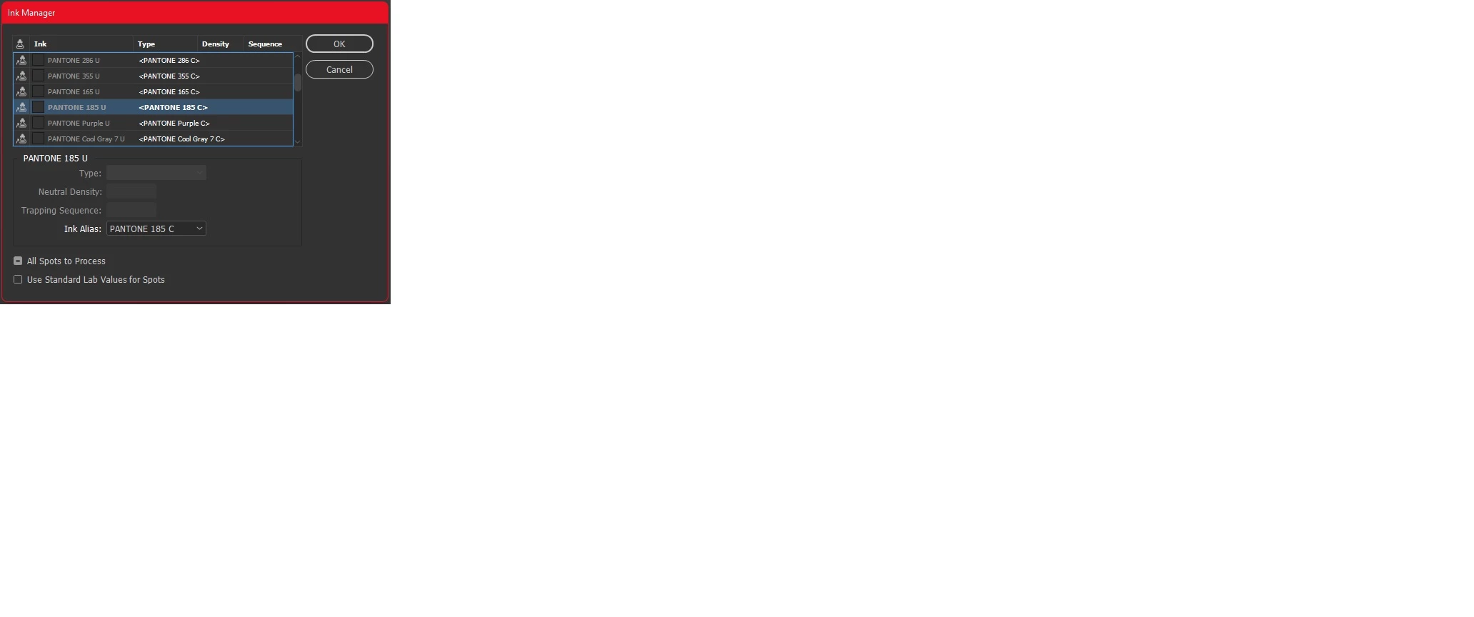

So am I to understand that just mapping the alias will result in the correct color going to the printer? The attached .jpeg file is how I have it set up now. Is this correct?

Mapping looks ok.
Yes the correct color name will be used during separation.
