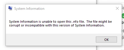

    when installing adobe illustrator this types massage show

    Hello @jouharul_3360,
    I am sorry to hear about your experience. Would you mind sharing more details, like the exact version of the OS/Illustrator, and a screen recording of your workflow and the problem (https://adobe.ly/3z5lxCd), so we can investigate this further?
    Looking forward to hearing from you.
