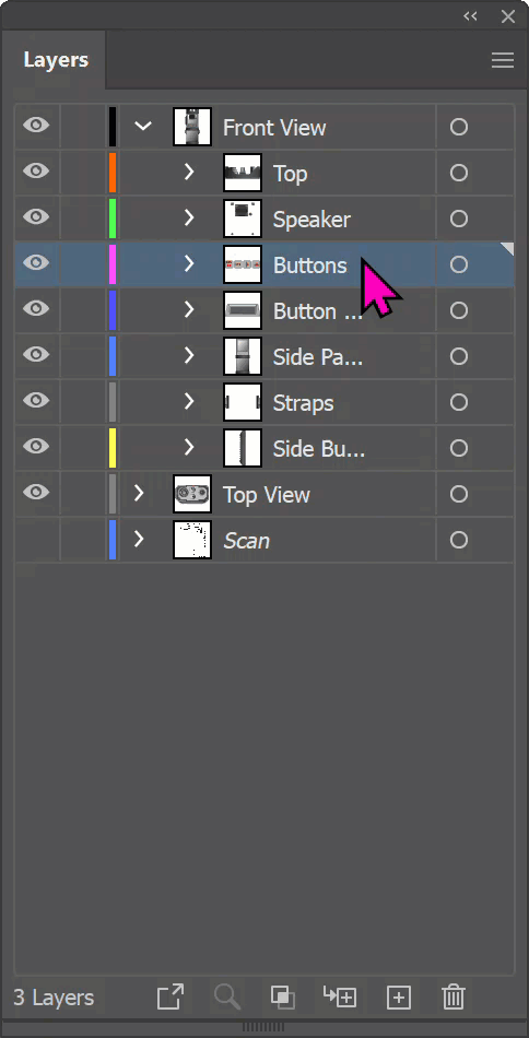

New layers start TOO FAR ABOVE IN THE STACK
I mean it's been years now
Why is it not poosible to create a layer where i am in the stack?  How many years do we have to wait to be able to create a layer right where we are in the stack versus having to scroll waaaay above somewhere to find the new layer?
And once the new layer is created (and resting at the top of the stack) then how do we move the layer back into the place where we were working ?  By selecting and dragging it of course which is more time wasting as it scrolls the stack at snails pace.
There is a new sublayer button, but this does nothing more than moves the new layer to the top of the existing stack versus outside of it, and is kinda a waste of development.
A new sublayer button does not address this problem.

OBJECTS are not LAYERS.
Objects are always created from the ground up.
If the OP wants to add a "layer" above one of the objects in his "stack", they need to make the object into a layer first.
Easy way to do this is to select the layer containing the objects in question and Release to Layers (Sequence). All the objects now have become separate sublayers, from the ground up, and they can add one directly above anu one they want.
Obvioulsy, this is not a workable solution with any layer with complex objects as you can have THOUSANDS of objects on one layer.
OR, select an object on the artboard and any new object draw will appear above wherever it is in the stack.

In case we are talking about objects (and not main layers or sublayers), it's possible by isolating the object (Isolation mode for single objects), then draw a new path above the isolated object.
To make that a bit easier, one can assign a keyboard shortcut to enter Isolation mode (see Edit menu > Keyboard Shortcuts) for single objects. Then select the object, hit the shortcut and draw a new path. It will be located above the isolated object. After that, hit the Escape key to exit Isolation mode.
Admittedly, it's a bit cumbersome, but it works.

The art layers, e.g.  <Rectangle>, are not the same as real layers, e.g. "Layer X" - everything in Illy starts from the top down, within the "real" layer, or "real" sub-layer (i.e it's a layer and not an object). AFAIK it's always been this way. Although it's probably more intuitive that you want to draw on top of the item you were just selecting, Illy doesn't actually know that, so places the object at the top of the drawing stack within the current ("real") layer, sub layer or sub sub layer etc.

Hmmm...as David mentioned, the new layer always appears directly above the layer that is selected when the New Layer command is issued. As far as I know, it's always been that way. Not for you?
Kevin Stohlmeyer
Apr 5, 2022 7:51 PM UTC
@John Mensinger @Dave Creamer of IDEAS I think what the OP is referring to is the sublayers not the Layer (containers).
If you are working on a sublayer and add a new sublayer it is automatically at the top of the stack inside the Layer container.
See below: I had rectangle 1 select and was scaling. Then I wanted to add an object directly on top - between 1 and 2. Adding a sublayer or drawing adds it to the top.
Changing the drawing mode to draw behind does put an object immediately behind the selected object, but draw in front (traditional mode) adds it to the top of the stack - not immediately on top of the selected object.
