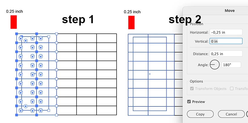

I thought this was what I was looking for but I'm not sure it's quite it. I'm looking for the best way to easily adjust individual points on an illustrator shape using specific dimensions or measurements. For example, I am making a sewing tech drawing but need to adjust one of the edges to be 1/4th inch longer. I don't want to adjust the whole shape, because it will adjust certain points that need to stay in a specific position. I usually manually adjust the coordinates by using my calculator to add or subtract the difference and imput that number into the transform panel, but that it very time consuming. Do you know of anything that would help here? Thanks!
Sergey Osokin
June 6, 2023
Can't you just select the right path points with a Lasso tool, for example, and run the Move panel?
pixxxelschubser
pixxxelschubserCommunity ExpertCorrect answer
June 6, 2023
@babynoogz
or simple write in the control bar (x or y coordinate) your desired value after the current value - in your case: +1/4 inch

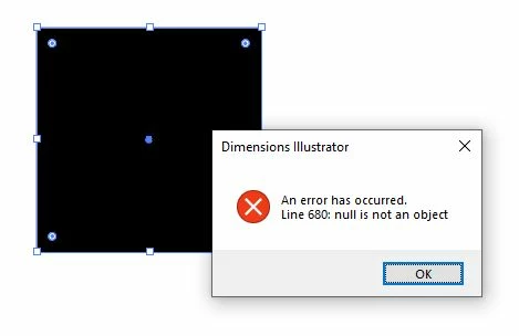

The script was working fine, the last time I checked. But now this eror pops up. Tried uninstalling and reinstalling didn't help. Also tried moving script to another folder. Still no luck. Need Help.
willcampbell7
July 31, 2022
It's the Illustrator 26.4 update to blame. I'm working on it now with 2 other users. Just got some test results from one of them. The 26.4 update, for tabbed panels, selection, no longer has the property 'index' that tells which tab it is. So when reading it to save settings, it gets the 'undefined' error. I am working on a interim fix at the moment. I'll have an update ready probably later today.

I'm getting a storage error though, "Line 2187: undefined is not an object". What can this be about? I have selected just a normal rectangle.
